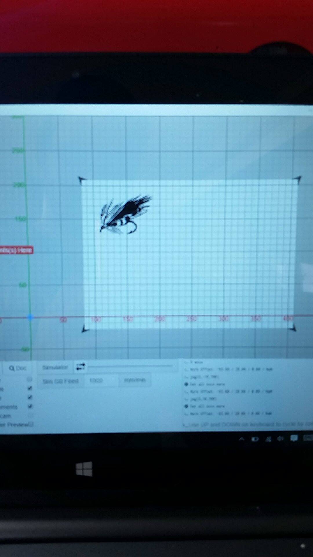

Hey all I have a friend that just did a conversion to smoothie but when he homes the bed display moves. Attaching a pic of the issue . Anyone have any ideas?
Settings -> Machine -> Machine Left X, Machine Bottom Y
ok i’ll let him know thank u kindly!!
Also: Make sure the Smoothie settings match the LW4 settings (esp. size setting!)
