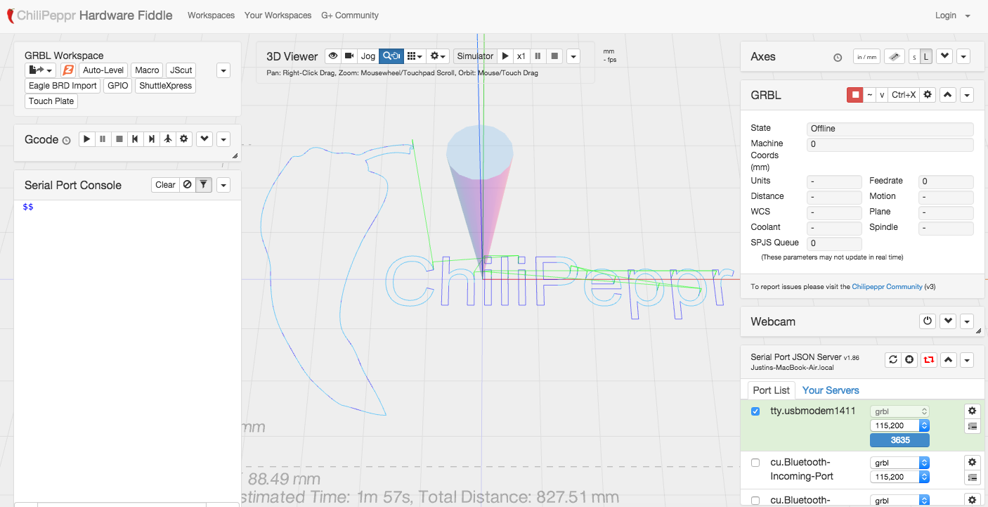

Hey all I have the Synthetos GRBL Shield and im trying to use it with ChiliPepper currently. I got my Json server going and what not but im just not sure where to go from here to get it going. Any help at all would be more than appreciated!!

Maybe that’s just how it looks on a Mac. Hit the “Ctrl X” button in the GRBL widget and let me know if the blue buffer that reads “3635” changes.
Yes it changed to 1.

Ok, why don’t you open up the axes widget and try moving your machine around?
Gave that a try and nothing. Also that SPJS Queue changed to 0 and blue buffer changed to 2

Are you sure that try.usbmodem1411 is correct port for your Arduino?
$$ shows no output and machine state is offline, seems you are not connected.
