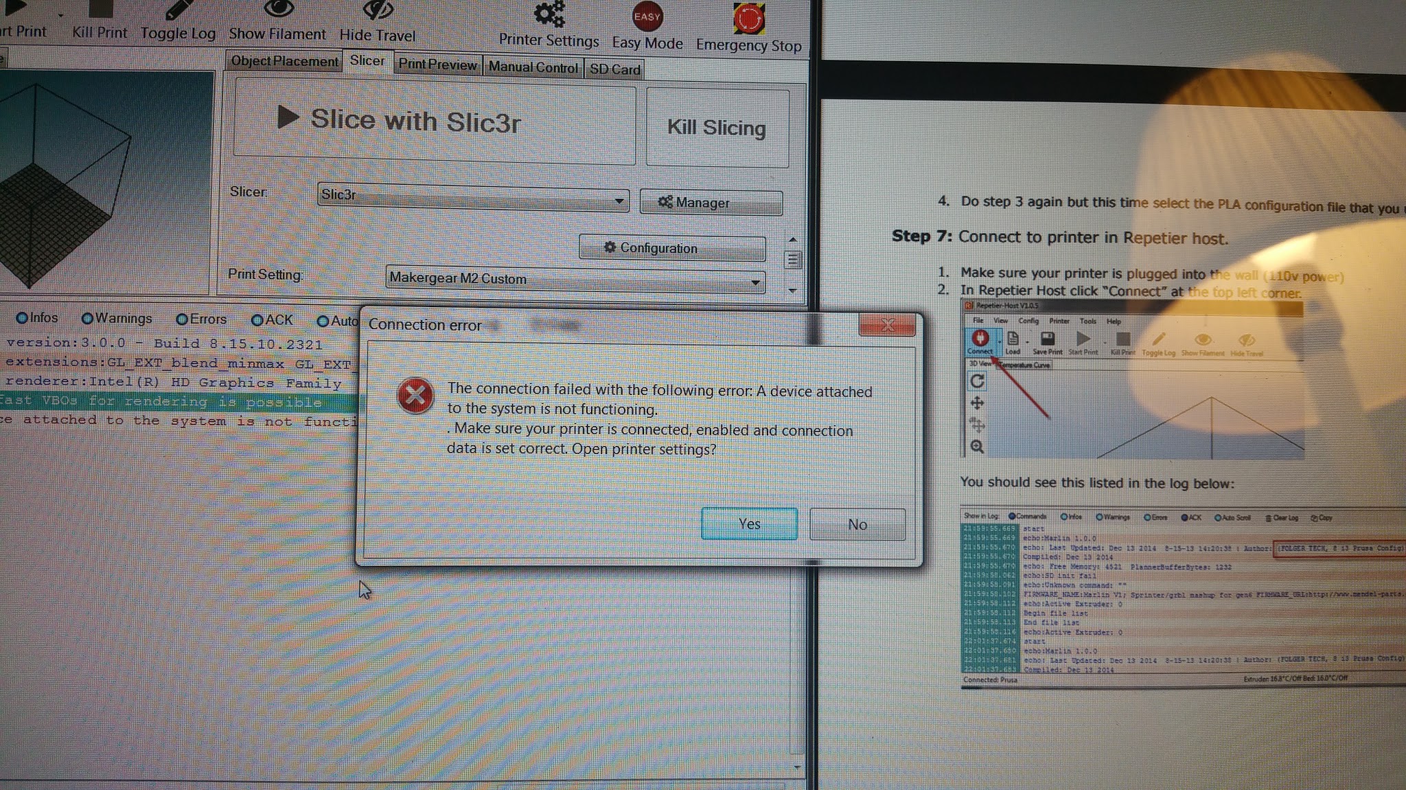

I just put together my first printer, uploaded the firmware, and set all the settings in repetier. I am trying to connect to the printer and I am getting this error. Any ideas?

Hey @Alex_Lee and @Akarshan_Mishra , I tried changing the baud rate but it didn’t change anything…it seems that using the current settings and the 250000 baud rate I can get it to connect but only intermittently and non consistently. It seems that when I can get it to connect that it times out. Any other ideas? Of course, when it successfully connects it shows up in the device manager, but once disconnected in repetier and upon removing USB, and reconnecting USB it’s not recognized in the device manager and thus not able to connect in repetier. Tonight I was able to get it connected for a minute and home all axis and heat up the extruder and bed but then the program quit when I began a print. I wasn’t able to get it to reconnect after that.
