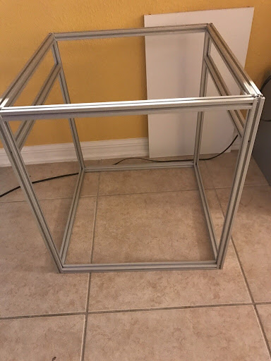

Hey all. I just started building my Eustathios and I have a couple questions. I have been using my own variation of the Prusa I3 for a while now and I have a touch probe for auto bed leveling. There are a few things I don’t like about it and I have seen a lot of people using the proximity sensors and I think I want to use that on my new build instead of the touch probe. What is a good one to use and will they work with an aluminum bed with glass over it? also trying to source some good but inexpensive ball screws or lead screws and nuts. Also what is everyones take on ball screw verses lead screw pros and cons. really looking forward to having a printer where the bed only moves up and down. I’m thinking I might be able to get better prints with this design. Any help is appreciated. TIA
