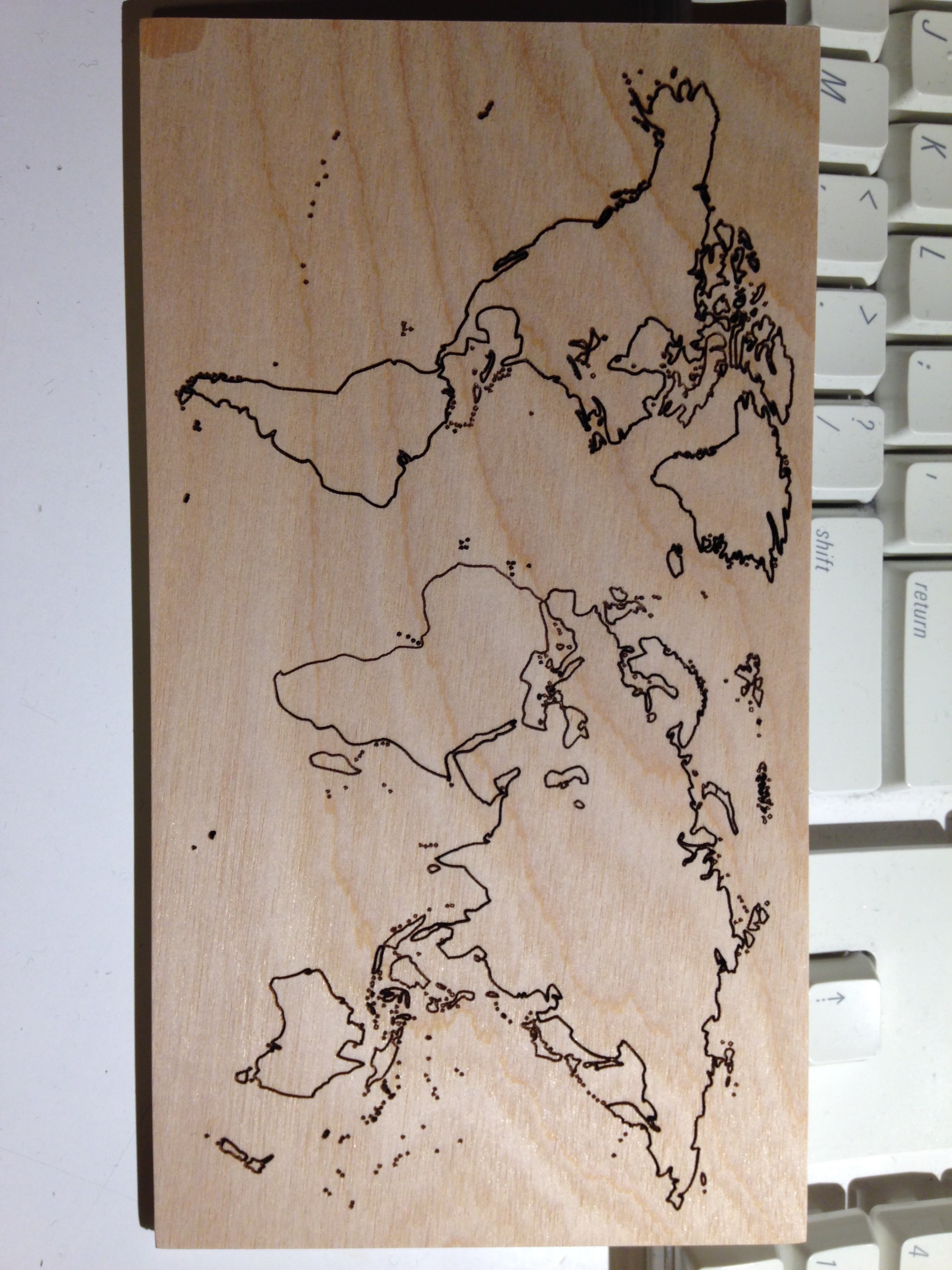

the c3d boards run off smoothieware which is capable of both. use svg for vectors or bmp, jpg etc for raster.
Awesome! Thanks man!
Excellent thank you for the example!
