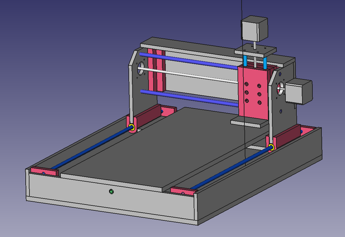

I tried it once too, but it failed to nicely drill through coper laminate. Than I thought of making CNC with help of 3D printer, it’s doable, but it occurred to me that it would be not worth it. You can see both tries here:
