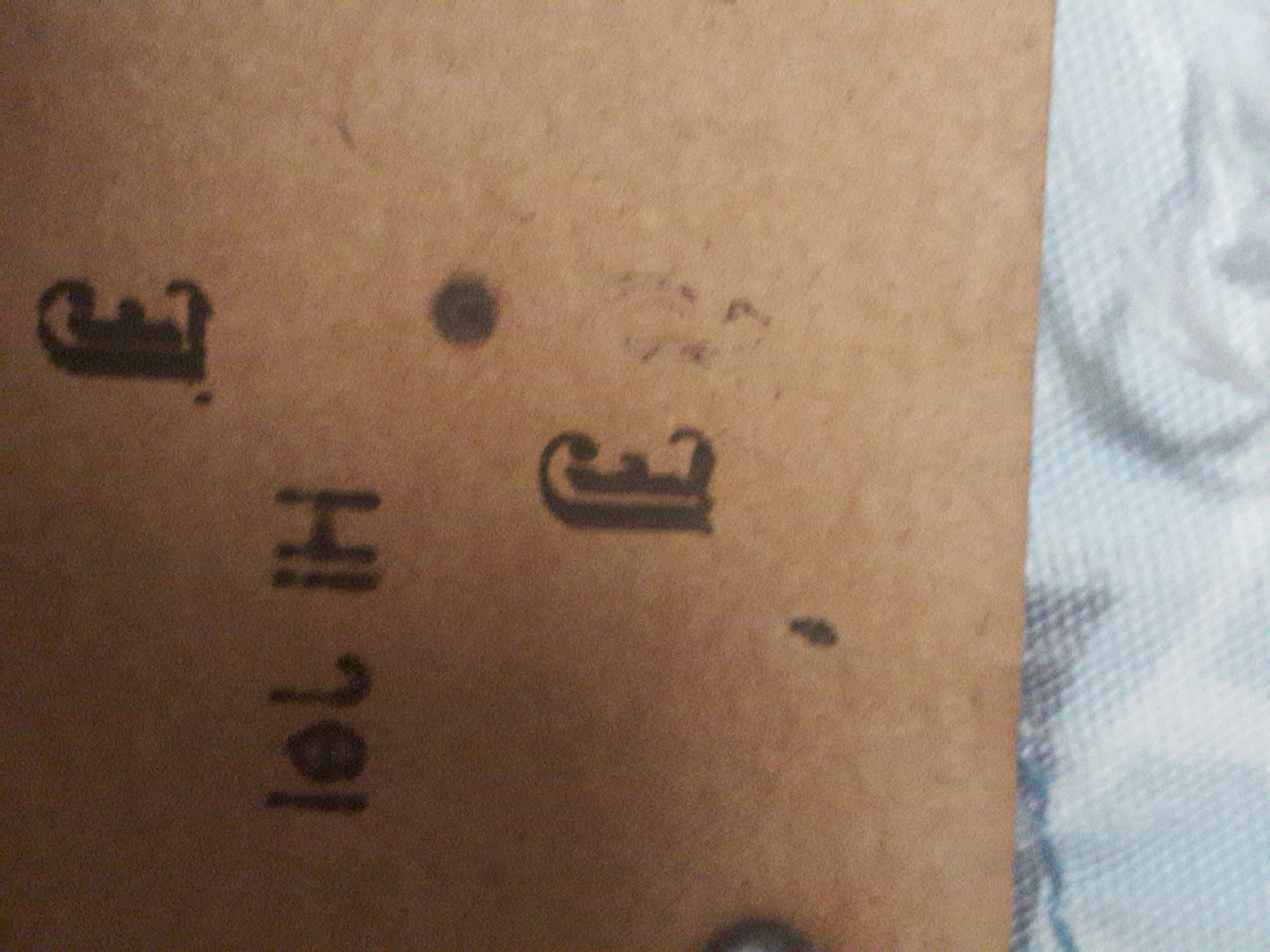

Hey all. I’m having some slight problems with engraving. When i try engraving a very small image, only two/three lines show up. If i make the engraving larger, it engraves the whole thing but there’s a lot of “white space.” In other programs I would just edit the lines/mm. I dont see this option/setting on laser web. Can Any suggestions?
Post an image of the result and also a screenshot of the LW información how you are creating the operations
turns out like this

Laser diameter needs to be 0.1
