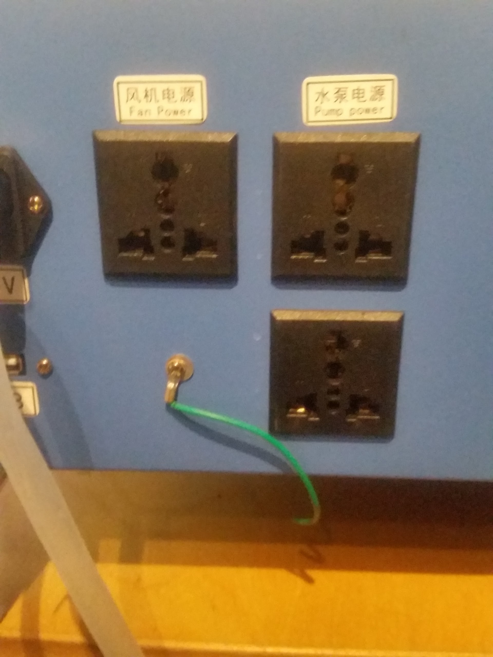

Hey All,
Laser just arrived from China.
Just finished uncaring it.
I have to dig out my volt meter, but will these sockets provide 110v?
Never seen this “type” before.
Everything seems good on the unit. Maybe a few tweaks here and there.
Kris
They seem to be multi purpose sockets that allow different international plugs to be used. If 110 goes in then i expect that it is routed to these sockets thru relays. Never seen this before. Maybe an new updated k40 version?

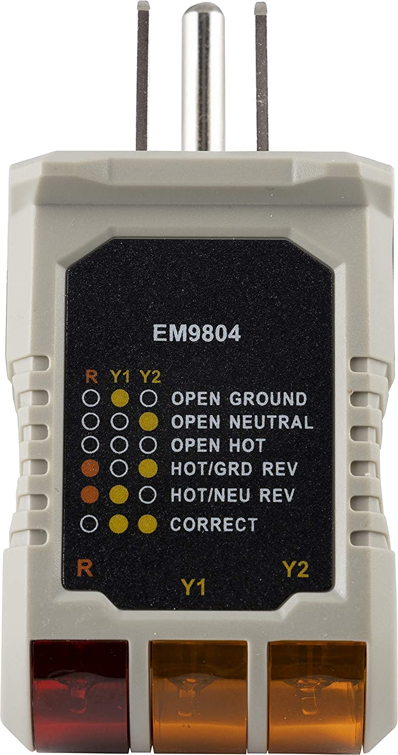

They should but pull out a meter or a outlet tester and check them.
Socket tester is the best cause you can test for gnd and backward wiring.
Hey buddy. Take a look inside the electronics area at the back where these are fitted. Trace their wires back from the main AC inlet fitting to these sockets, as I am sure they will be like mine and daisy chained from it. Mine do not have the earth (ground) wire linked so will be no good for components requiring a ground. However the exhaust fan doesn’t have an earth so I have mine plugged in here. If they are daisy chained together, whatever voltage you will connect to will be available at these sockets. I wouldn’t suggest connecting high load items to them though, but your fan and water pump are low amp draw items
That is how mine came as well, after looking at it a bit I realized it was a universal plug (pretty cool) And it will be whatever the voltage of the machine was set up to. And it will only put out what you put in.
Also note they are not grounded.
