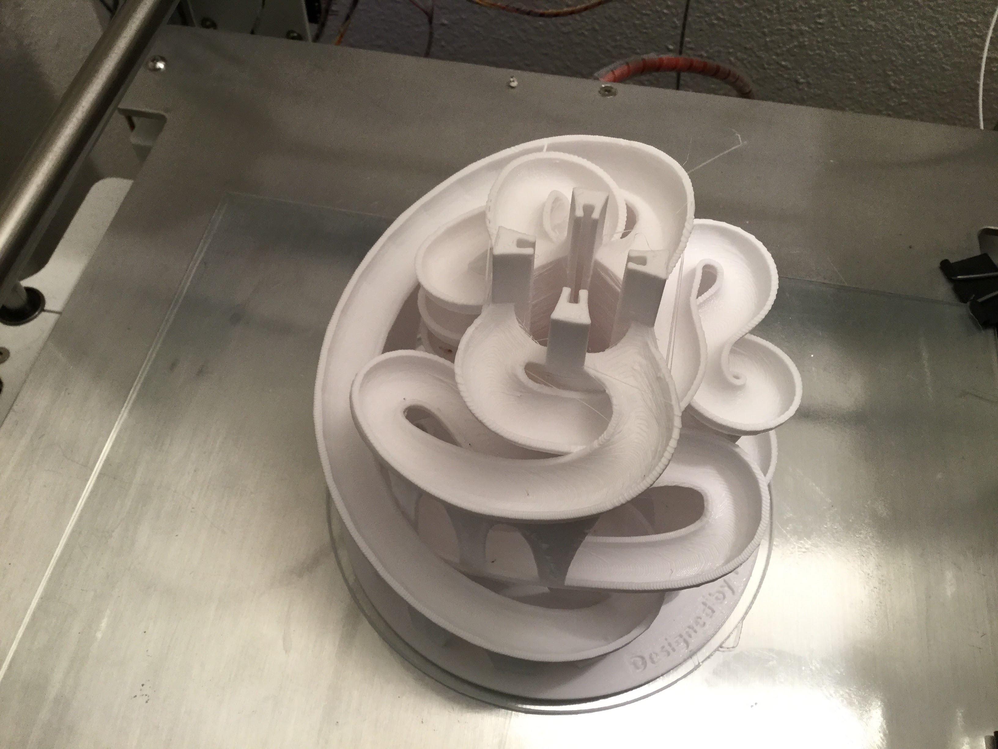

Hey all. Trying to get PETG tuned properly, finally got past the point of print failure due to blob buildup. But just can’t quite get these little zits to go away.
Now running at the very edge of under extrusion (as can be seen in the top surface of this photo) with 0.45mm coast and 5.5mm retract with -0.5mm restore at 242c at 3600mm/min.
Lowering the temp seems to result in poor layer adhesion on a brand new roll of eSun PETG. I can I suppose keep increasing coast and decreasing restore but it feels like they are high already.
Any suggestions?

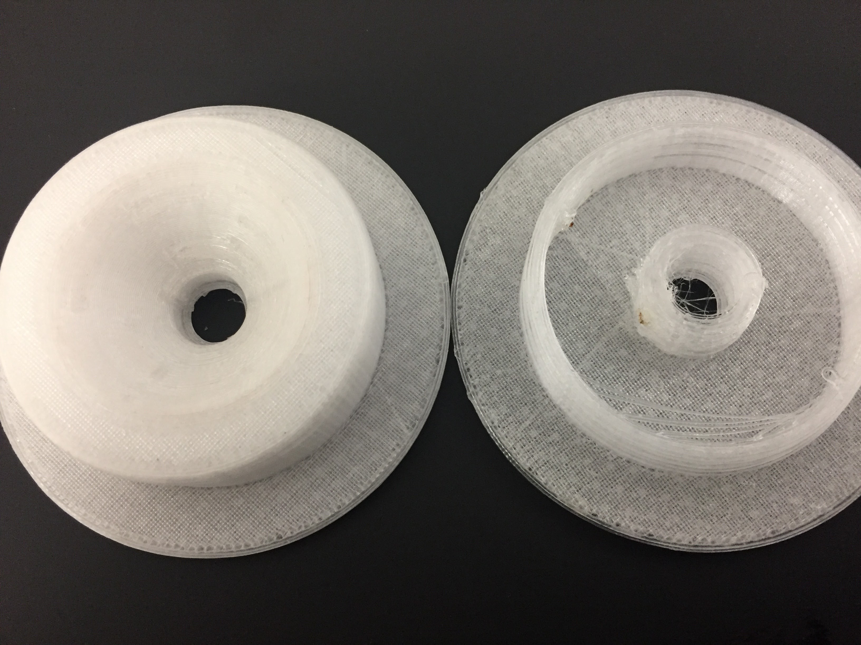

With the last bit of eSun natural, I set off to print a new spool holder for the eSun spools.
+Eric Lien was right in his response to a previous question of mine… How fast you can go really depends on the geometry.
As you can see from the images, first attempt (right) was a fail. I tried to merge two spool holder designs, which ended up being thin walled islands. Even with the print speed SLOW (40mm/s), I had blobs which resulted in layer shift. This print had some retraction (~2mm @4mmm/s), but no coast and under 1mm wipe.
For the second attempt, I changed the design to eliminate the islands and just for fun decided to change my settings based on recommendations by +Oliver Seiler and +Brandon Satterfield.
Kept temp at 235C, increased speed to 50mm/s, with 90% for outer perimeters. Added 50% fan (one of two fans running FULL ON). Retract 6mm @30mm/s, .3mm coast, 5.0mm wipe
Other than some light sanding to get rid of the retract/restart artifacts, it came out great - the infill also looks a lot cleaner.
Not sure how much of the improvement was due to the design change, but I’ll try to print the first design again with the new settings to see if it makes the difference.

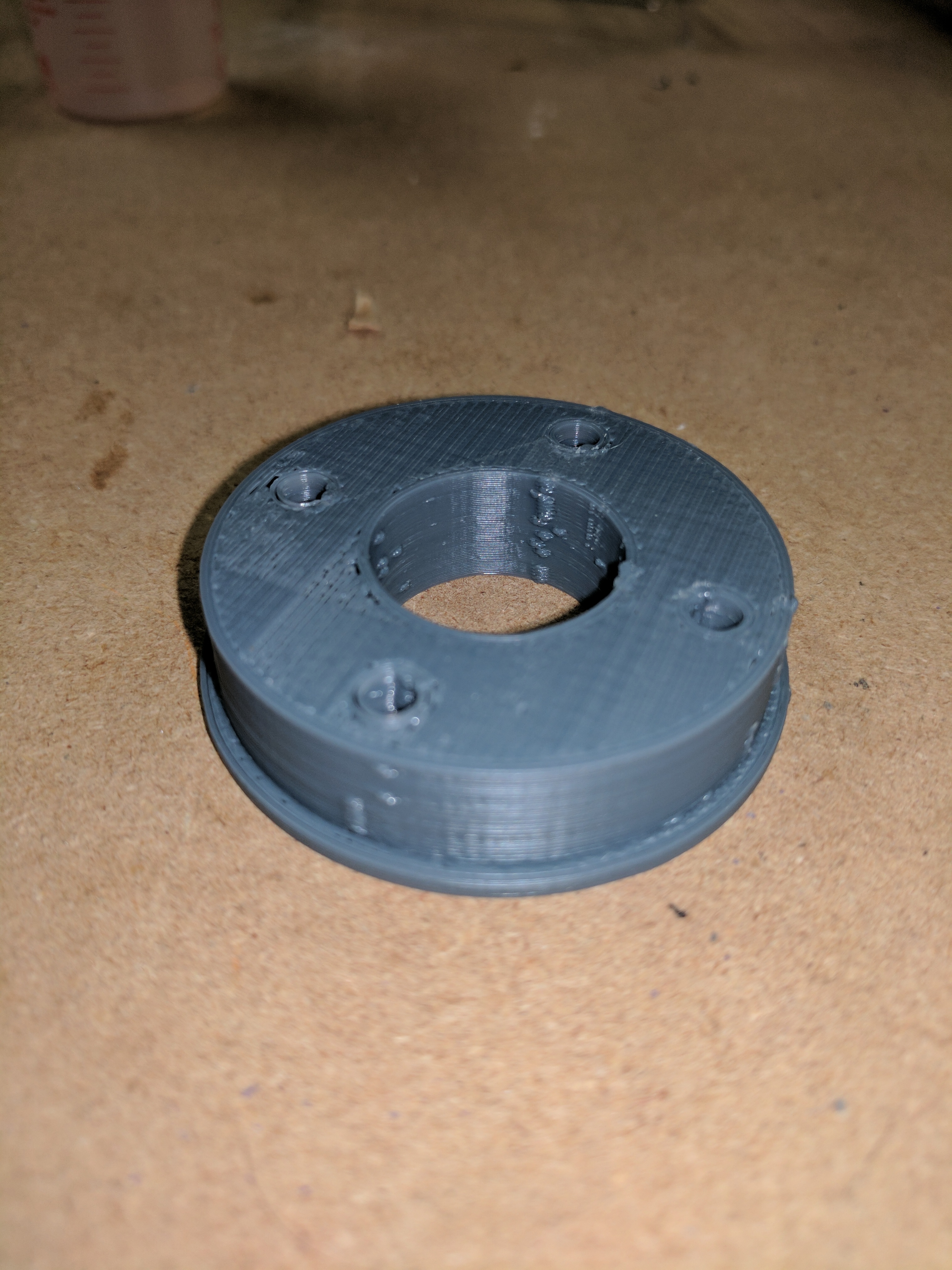

@Benjamin_Liedblad I did the tuning with the 40x20_ piece to tune the wall size to 0.4mm, so I’m pretty sure its right now. Using 1.13 multiplier to get the 3 straight walls pretty much spot on, the curved one is a little out. I then backed off further till I noticed a little under extrusion just to make sure.
Ok more trials this week.
Tried some of the above, have found that printing slower (40mm/s) definitely helps. Wipe of 5mm seems to aid in getting rid of the blobs, but I’m still getting build up, even after going a little past the point of under extrusion.

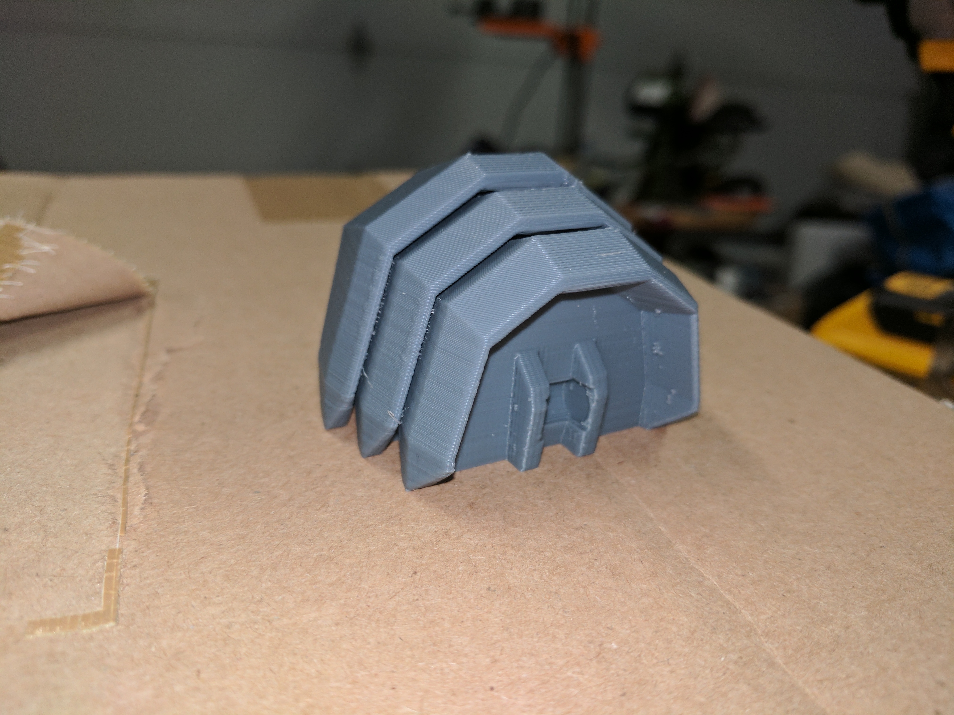

Ok so I reverted to some manual PID settings and things are definitely better. Holding steady at 240 with 54% power with fan on 30%, still need to do some more tuning so I can push that fan up, but my prints are a lot better now. This 3d printing lark is a huge time sink isn’t it?
Well what a difference some tweaking makes! Printed this part of the pangolin critter yesterday, much much better. I’ve got a little under extrusion on the top which will need dialing back a little. I think I might have something wrong in my setup still to be honest because this is definitely under extruded, and i’ve had to set coast to 1mm and 5mm wipe to avoid the blobs. From careful watching of the print its clear there’s a backup of pressure in the nozzle, since when the head moves away from a wall to a free area a few mm of filament extrudes immediately. Under extruding and this large coast have helped reduce this to something small enough to not really be an issue, but I’m still unsure as to why the pressure build up is happening in the first place. Any ideas? This is at 40mm/s, 245c.
