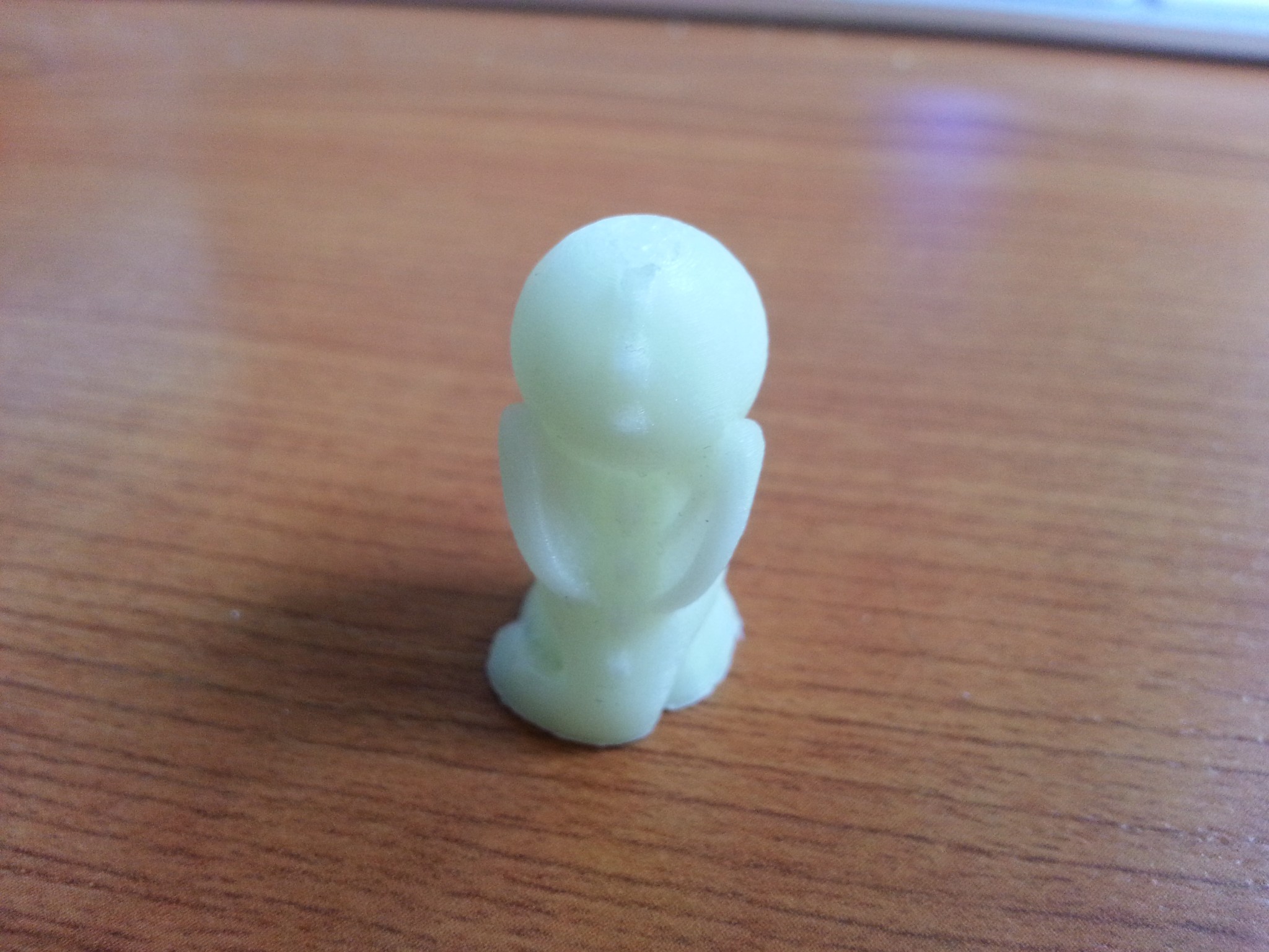

Hey @Ben_Van_Den_Broeck - look i’ve printed Cthulhu sized 0.25 and with 0.1 mm Layer Height in GlowBug Yellow. It glows in the Dark
0.1mm? wow!!!
will try one in 0.05mm tonight
@Nils_Hitze keep us updated!

@Marcus_Wolschon it needed around an hour, printed with 40 mm/s for inner/outer perimeter and 50 mm/s for infill, with 10% infill and 190 Degrees. First layer was 1, will do 3 for the top layer
