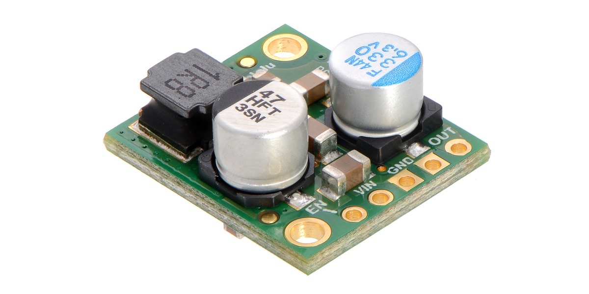

@David_Brenchley Unfortunately all those appear to be large bulky units that would be used for supplying an entire system. I’m looking for the little PCB type converters like this: https://www.pololu.com/product/2107 but obviously with much more than 600ma output. I’ve seen a few suitable things on eBay and such, but I’m not too sure of their reliability. Hoping someone with experience can suggest something specific they have used?

Pololu offers the smallest and most reliable buck converts that I have ever used, though they are not the cheapest. This model should be more than ample for your needs:
