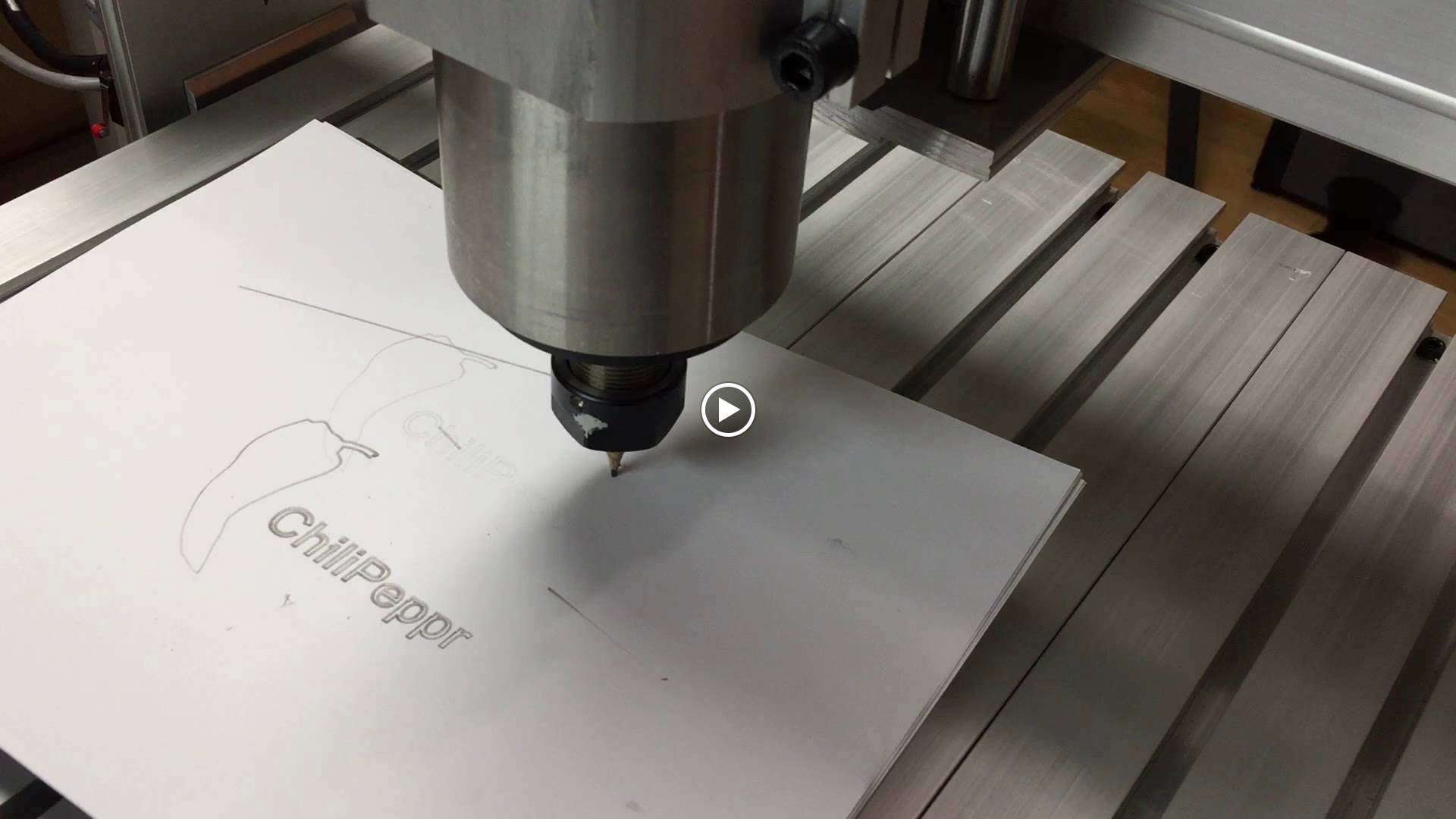

Hey everyone, I am pleased to announce great success with my 6040 raspberry pi
Hey everyone, I am pleased to announce great success with my 6040 raspberry pi build. I have a question regarding G54 zeroing. I’m finding that I can only set the G54 position once, moving an axis and attempting to set again does nothing. I’m also noticing that sometimes, not always, if I go to G54 zero after a job has completed, that it runs away as if the job finish location was MCH home. Would this be a TinyG or chilipeppr issue?
TinyG issue. I have found similar weirdness using WCS with TinyG.
