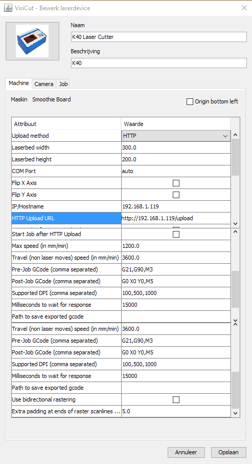

Possibly… Guess I just need the pre and post G-code, DPI and i’m curious what speeds fellow K40 owners are using.
This is what I have now (most are the default values):
That all looks ok, start with that.
