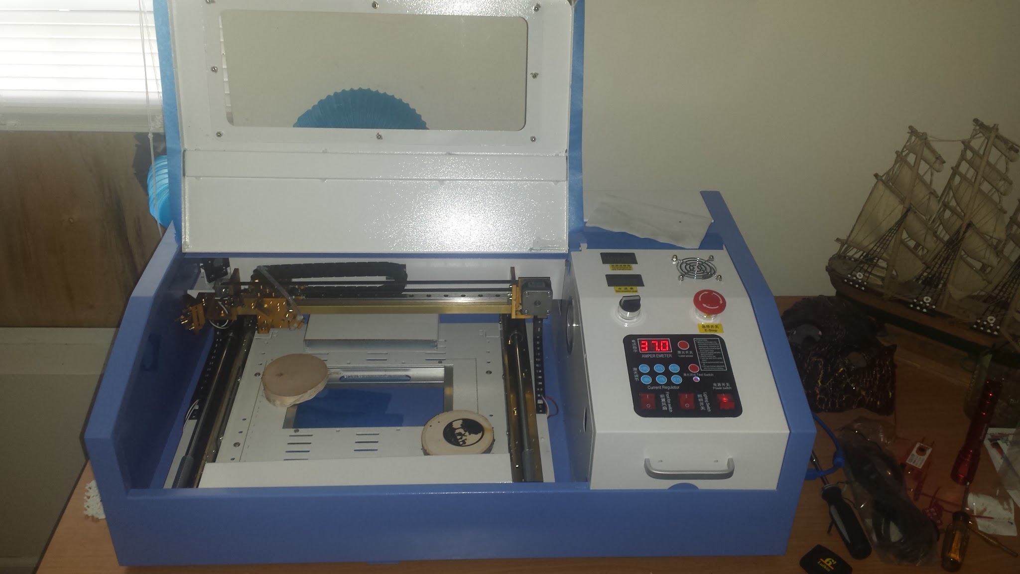

hey everyone im new to the k40 laser,
hey everyone im new to the k40 laser, only had mine for a couple of weekends

@Dinesh_C_Holla any thickness depending on the speed and amp I’m run at 300 mm and 30 amps

I don’t think it actually is 30 amps Chris. As far as I’m aware, these K40s that come with the digital “ammeter” are actually showing a %, not a mA value. Have a look around the group posts, but if I recall correct, the laser fires at 18mA max (or maybe 18mA is the most you should fire at).
@ Yuusuf yeah, i am very sure its not amps… its a digital meter showing percentage thats it…
