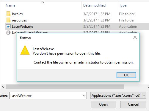

I am running 1.1f. I have downloaded LaserWeb4, but am just getting permission errors.
Permission errors of what sort?
“Windows cannot access the specified device, path, or file. You may not have the appropriate permissions to access the item.” I’ve tried running as administrator and changing permissions on the .exe file.

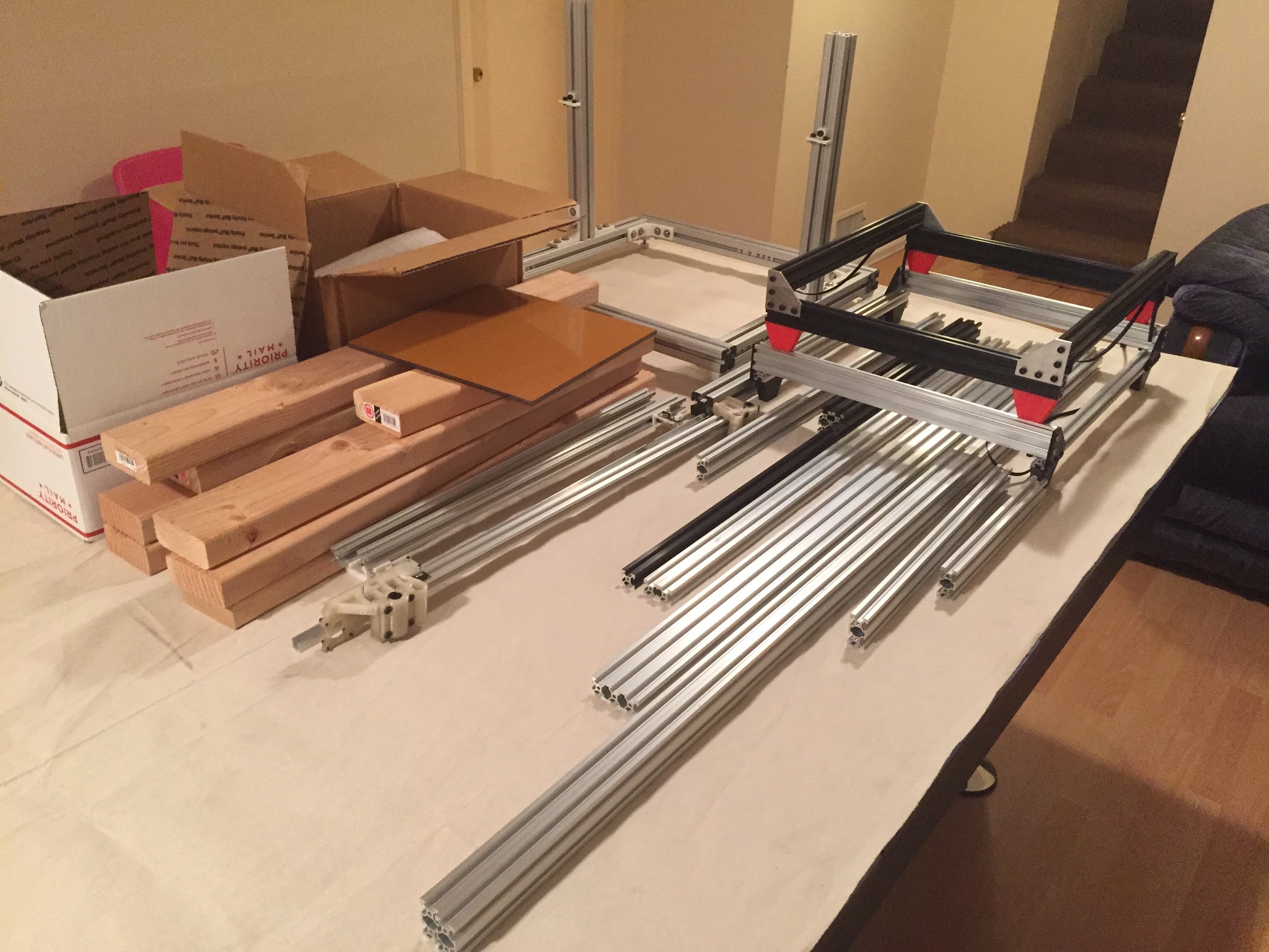

@raykholo Neat! I’m running the machine I made with OpenBuilds Vslot with a diode.
Sweet! I dug up my openbuilds stash yesterday… Figured a huge diode laser build is exactly the sort of thing one would do with this stuff. Will get there eventually.
Let me know if you have any board questions, and I’d love to see your build at some point!
Wow! That’s quite the stash! I could only afford 5 pieces of rail and the stepper motors, so I used Inventor to 2d model the gantry plates, so that they would hold the steppers and ride on skateboard bearings. I used my school’s laser cutter to prototype them in acrylic (to find tolerances etc.) All tied together with a belt and pinion design. :slight_smile:

@Andy_Walker did it show you a firewall permission when you installed it? Is the only thing i can think off. Please go to windows firewall and add laserweb as permited

@Andy_Walker ​ new binaries available updated today
@Ariel_Yahni_UniKpty I get this error when adding LaserWeb.exe as an allowed program…
Is this from today’s download? Did you check the Windows firewall?
