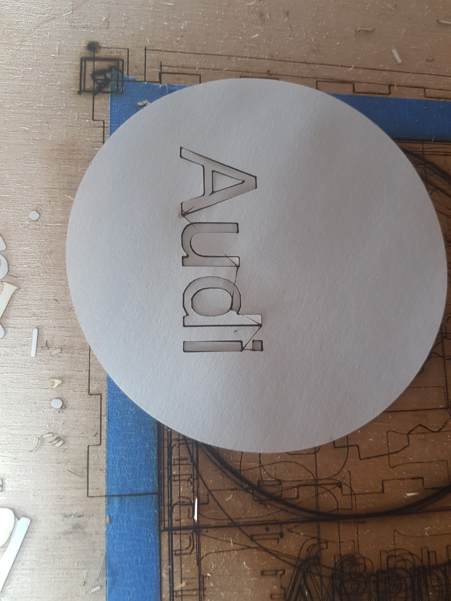

Just got my laser cutter up and running. Got it cutting square. I have been using T2, and have been having issues with DXF’s.
Tried LaserWeb and it fixes the issue I was having with T2, but it also cuts all the travel lines (the lines that show up in green on laserweb)
Am I missing an option? I’m running grbl 1.1f.

Got it, needed to put it into the Tool Off section in the Gcode settings.
You need to enable laser mode.
Under gcode start add $32=1 under gcode end $32=0 I did this because in my case its a CNC machine.
