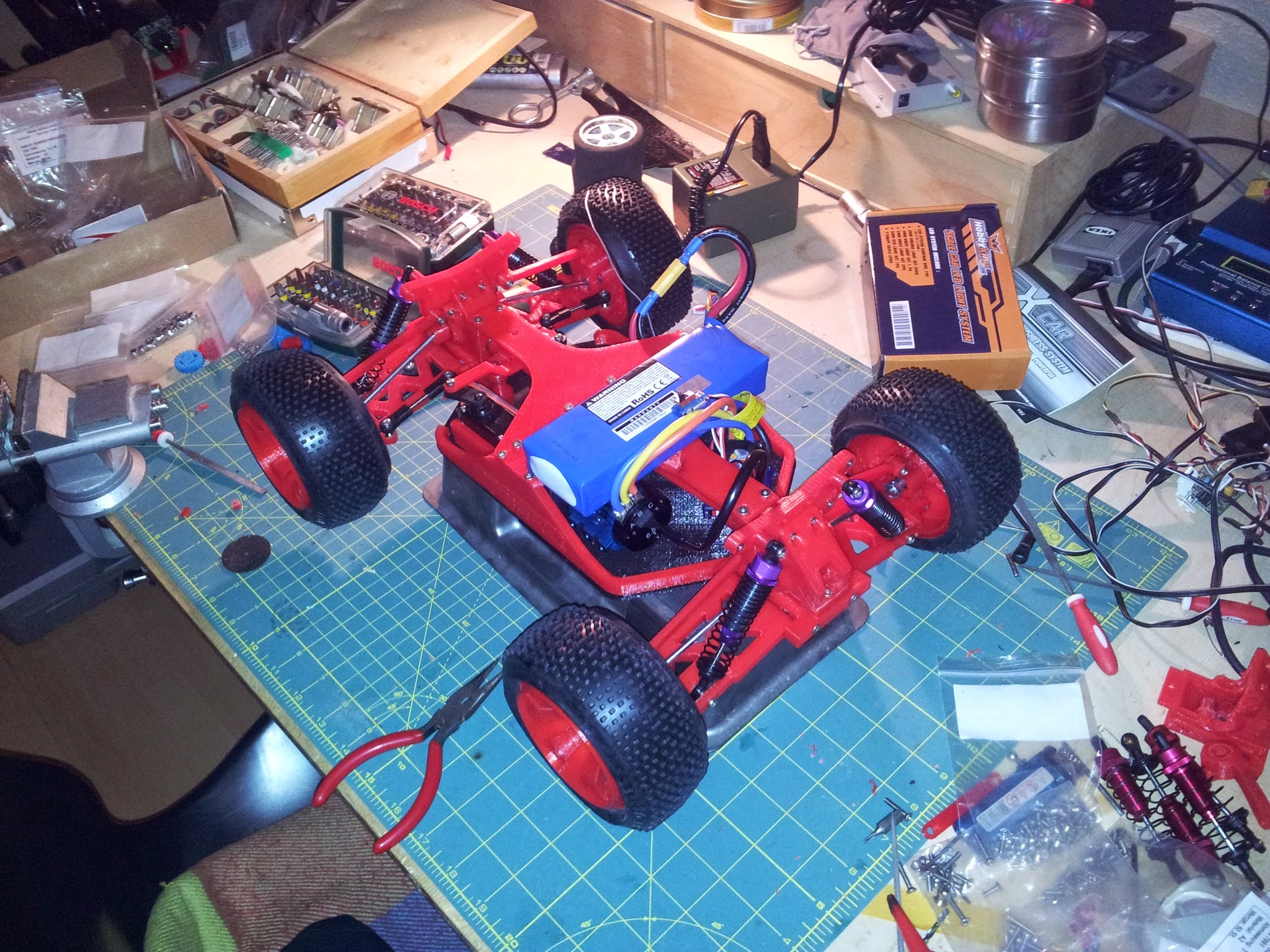

First of all Thanks to +Daniel Norée for sharing the OpenRC Truggy and parts. I finished printing and assembling my Truggy yesterday. My problem right now is that the differential gears were broken after I accelerate. I printed all with PLA.
So my question is, is it enough to print these gears with ABS insted or should I buy some aluminium one?
