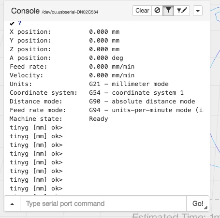

I have the C beam installed, And hooked up the Tiny G to my meanwell power supply. I have downloaded the FDTI driver and went into chilipepper, I downloaded the JSON server. I get a “Serial Port Ajax Error” when connecting but get the info from the picture below when I select the port for the tiny g…
I go to jog the machine (i am just testing motors) and nothing moves no matter what I do when I try to connect it did I miss something? Thank you so much for any help you can provide
There is a setting to change modes. I am not at my TinyG right now. If it is in normal mode typing G0 X1 should move a motor. If it is JSON mode the commands have a more complicated syntax. https://github.com/synthetos/TinyG/wiki/JSON-Operation
It’s TinyG that has to be in JSON mode, not ChiliPeppr. ChiliPeppr can only communicate with TinyG in JSON mode. So if TinyG isn’t in that mode nothing will work.
