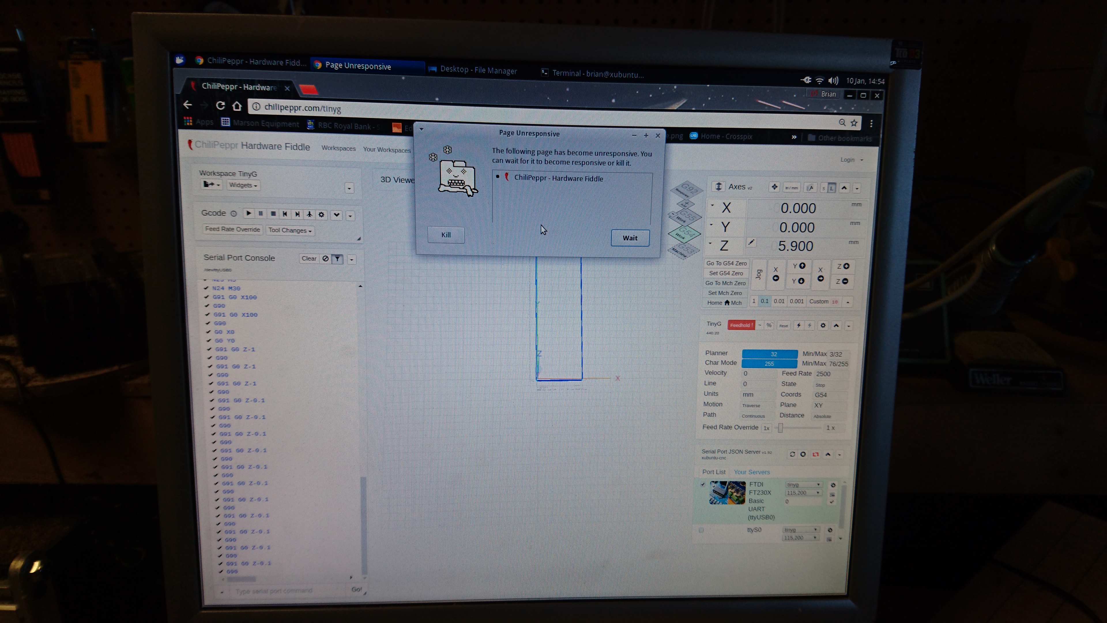

Hey folks, I’m having a bit of an issue here. Today I went to do a small job on the CNC and chrome is being incredibly unresponsive. The job itself is running fine but trying to jog the machine into position or any sort of interaction with the browser is extremely laggy. Any ideas where to start troubleshooting this? I’m running Xubuntu. The OS and chrome are both up to date. The computer itself is very responsive and if I open another tab in chrome and navigate some Web pages the browser is very responsive as well. It’s like it’s having a problem running Javascript or something. Any ideas would be appreciated!

@Andy_Meyer @jlauer I tried Firefox but the 3D viewer doesn’t appear to work. I ran a top command in a terminal and noticed that SPJS was hogging the CPU along with Chrome. The CPU load was nothing until I hit the check box in ChiliPeppr to connect to SPJS, then the CPU utilization went through the roof. Interestingly, I killed and restarted SPJS and all seems fine. Load average is down where it should be and everything is functioning properly again. I’ll post a couple screenshots. Should I try and replicate the problem with SPJS in verbose mode and post its output?
Can you try the new 1.93 of SPJS. I think this is the same bug somebody else just posted about on the CPU utilization in SPJS and I think it’s fixed in 1.93. https://github.com/chilipeppr/serial-port-json-server/releases
Yes, I didn’t realize I was on a previous build. I won’t bother with the screen shots right now then.
