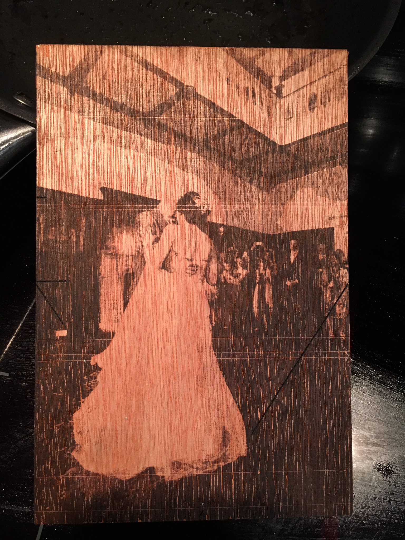

Thanks for the info. I thought it was sorted but after an long engraving and going for the cut out it still did the same thing. Pic attached. I did a cut of 3 passes and I am wondering if that was the issue? I am creating a rectangle in Photoshop filled with white and a line of 1 pixel then saving as a bmp and importing into LW. Could this be the problem? I have downloaded fusion 360 but not got around to using it yet as the last time I used cad I was still growing my first pubic hairs!!! I am 40 now!
Just for info I hit the laser activation button when I saw the laser go off track, hence why the lines don’t go all the way across. I will try the TTL config tonight and have another look.
