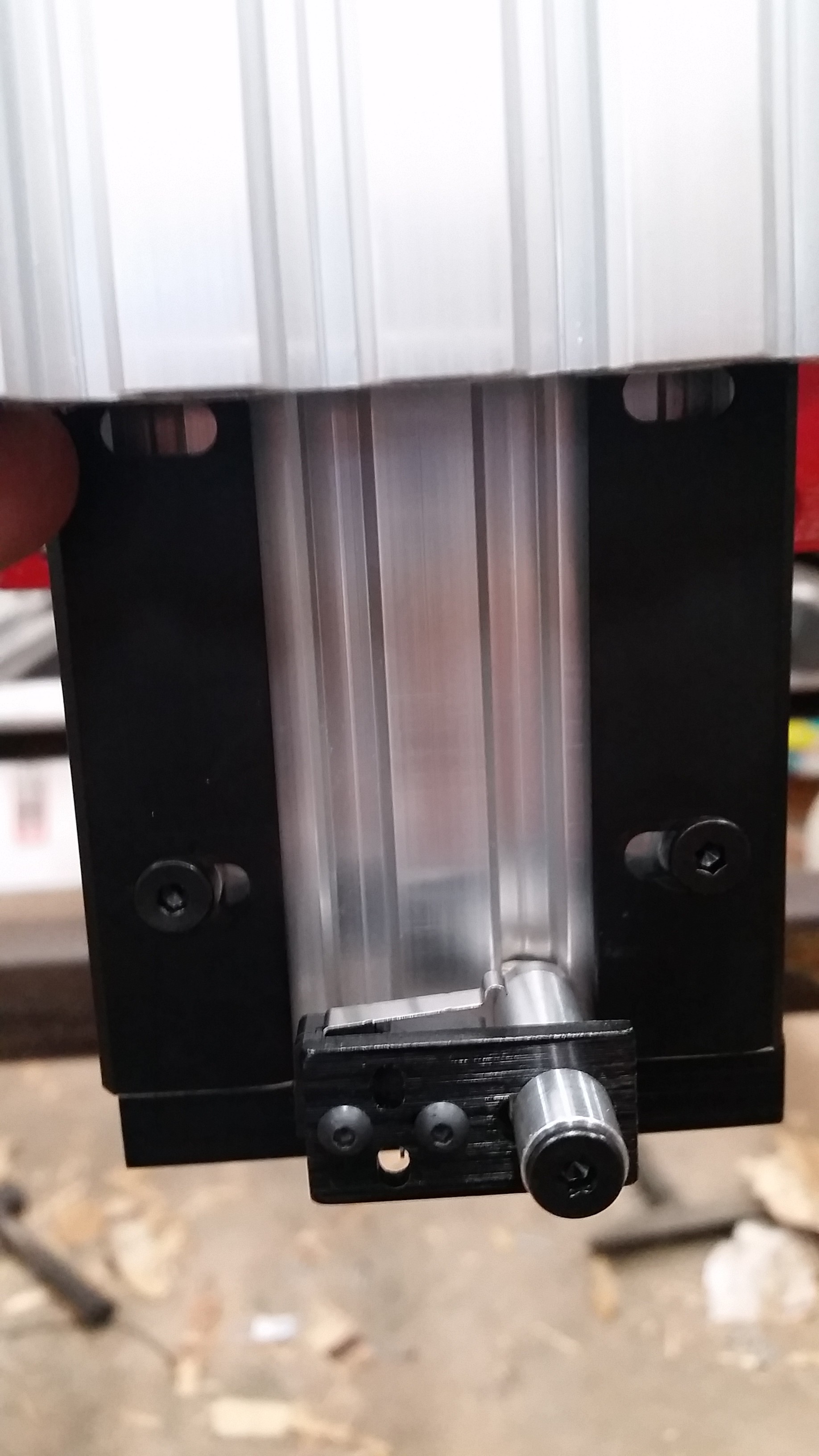

Anyone out there familiar with planet cnc and sheet cam? Or either? I have set up my plasma with a floating head with a limit switch located on the bottom of the axis (will need to build a shield for it or move it).
