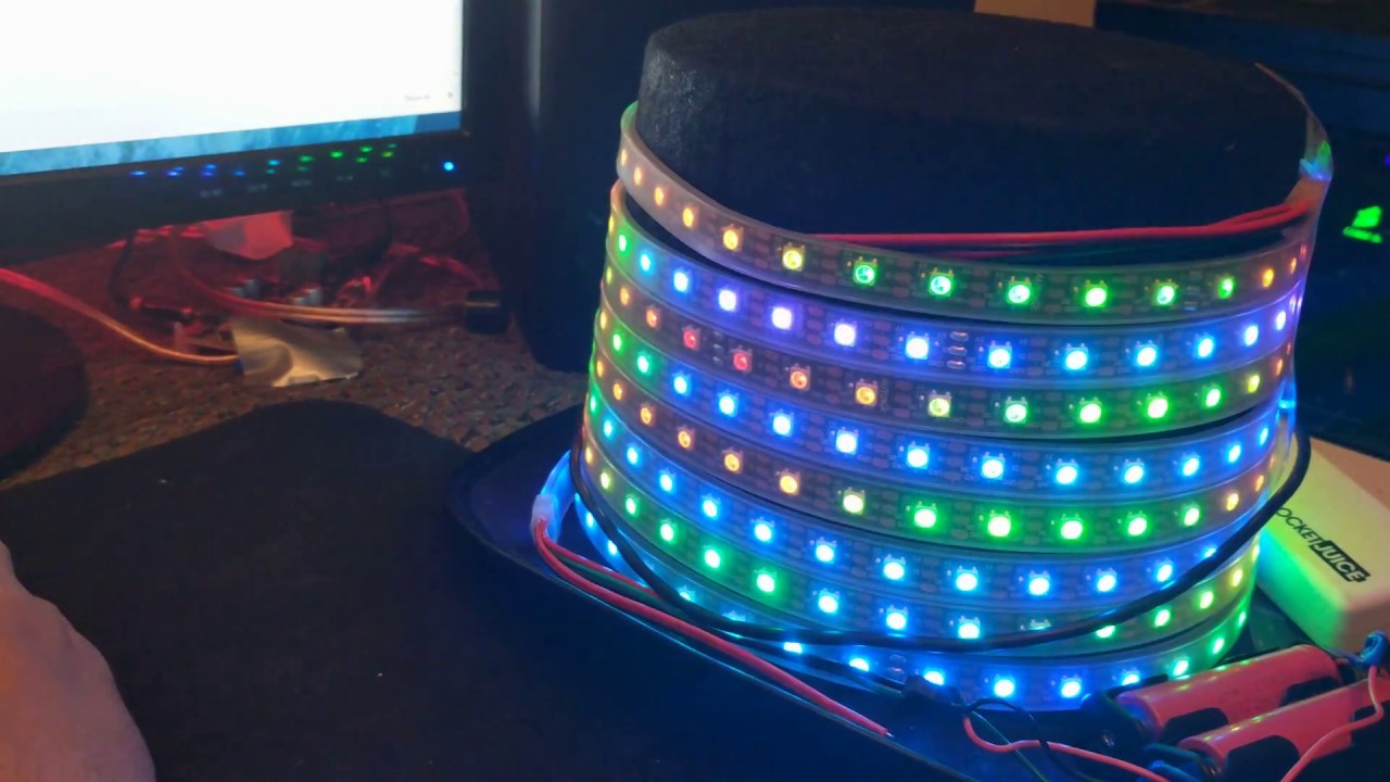

I made a board with 10 rows of 42 led strips WS2812B in serie instead of 1 strip as in this video (this for better aligning)
This hooked up to an Arduino Uno and a regulated power supply.

Also here is my hat.
