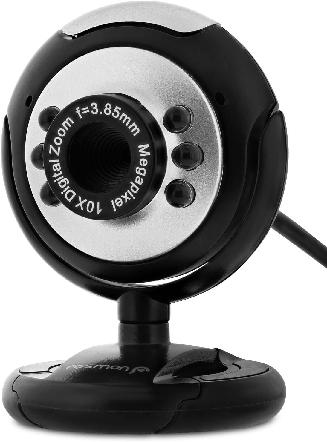

Well guys, my new webcam came, but I can’t seem to get the pi to like it. Bought this one since I saw someone else recommend it for octpi:

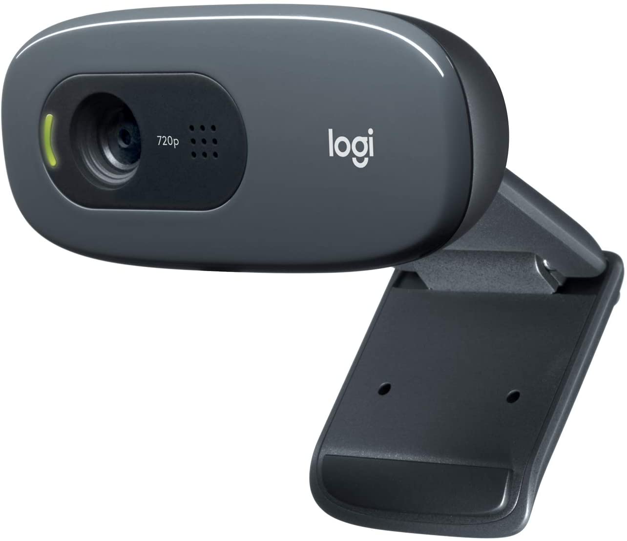

@foosel Alright, so after that 2nd camera wasn’t working, I ordered that Logitech c270 that the wiki said has been tested:
Hopefully that will make my troubles magically go away. If not, I’ll assume it is something I’m doing wrong on my end.
