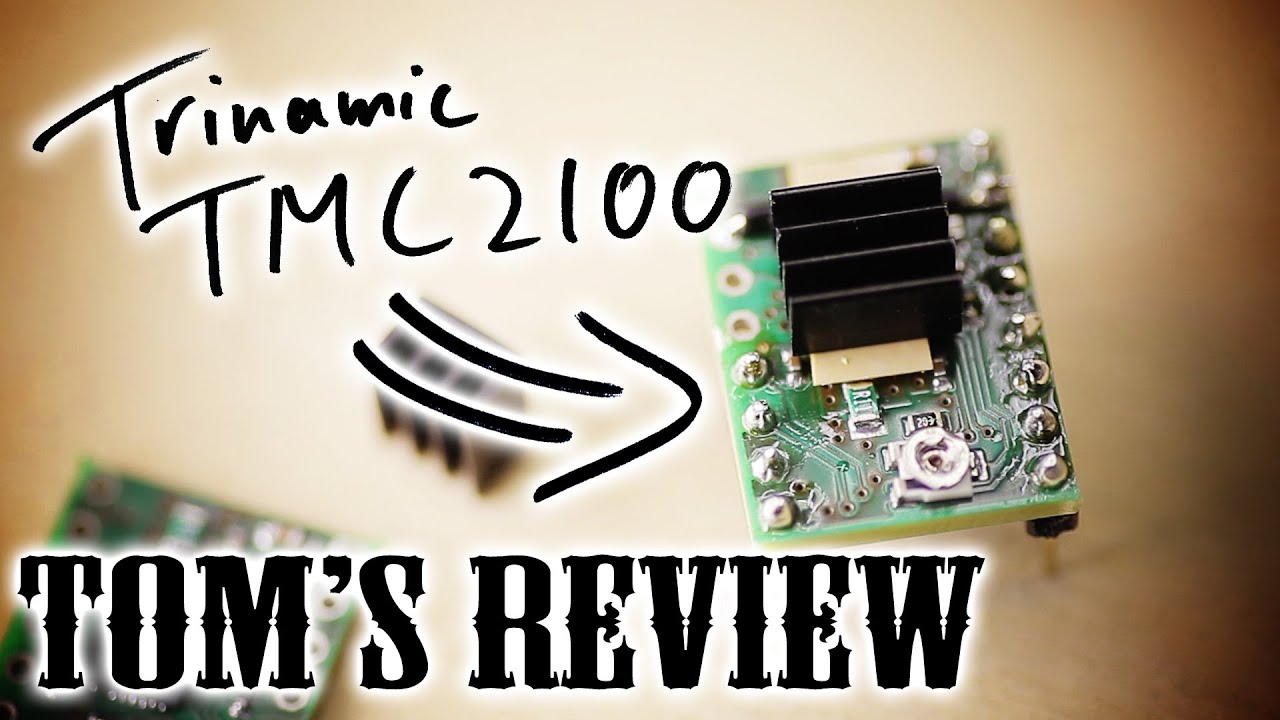

I’ve heard the DRV8825 is quieter than A4988, too. However, you might want to consider Trinamic drivers.
