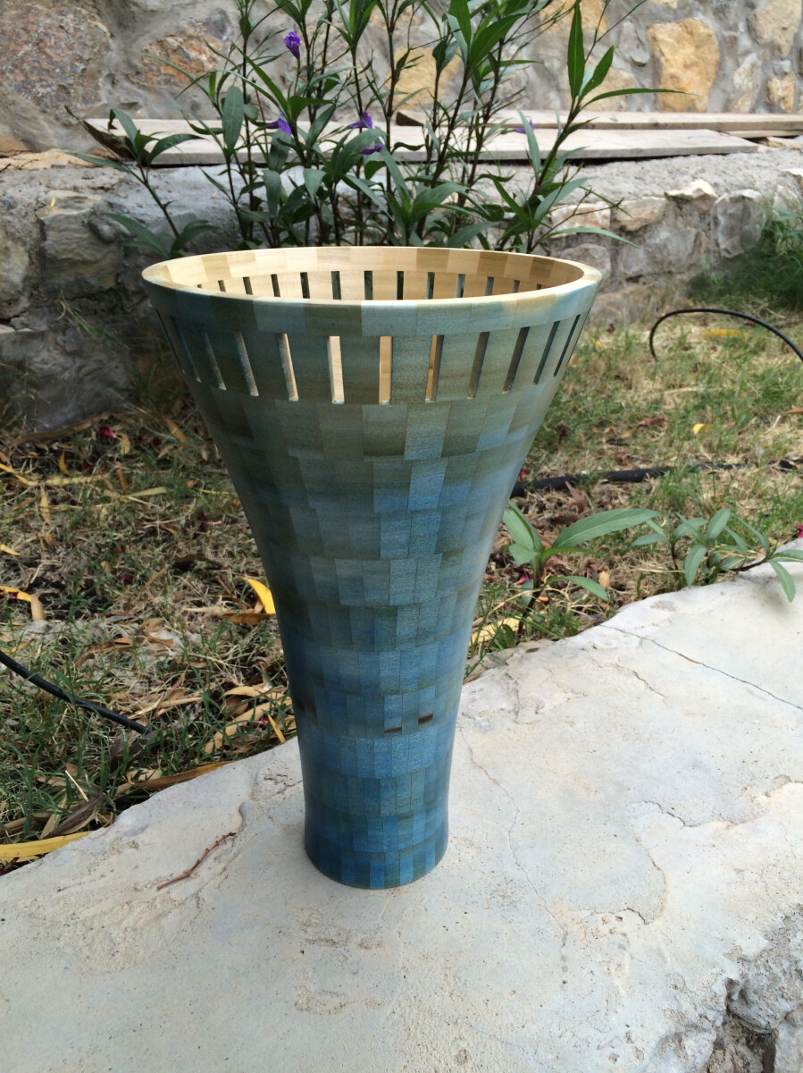

It is of course a work in progress. I mounted a stepper motor on the outboard side of my woodworking lathe. Normally, my lathe can only index 24 divisions. This widget lets me choose any number of divisions and index back and forth around the circle. it is currently set up to send a 1 for a full 360 degrees, so if I send .125, it will move 1/8th of a circle. I use this feature to add ornamentation to bowls and also to construct open segment vessels. You can see one here:
I used the indexer to add the open segments to the ring underneath the top ring.
That’s really cool stuff. I think the use case is great and glad you were able to create your own workspace and to get your indexer widget created. That vase looks really slick.
