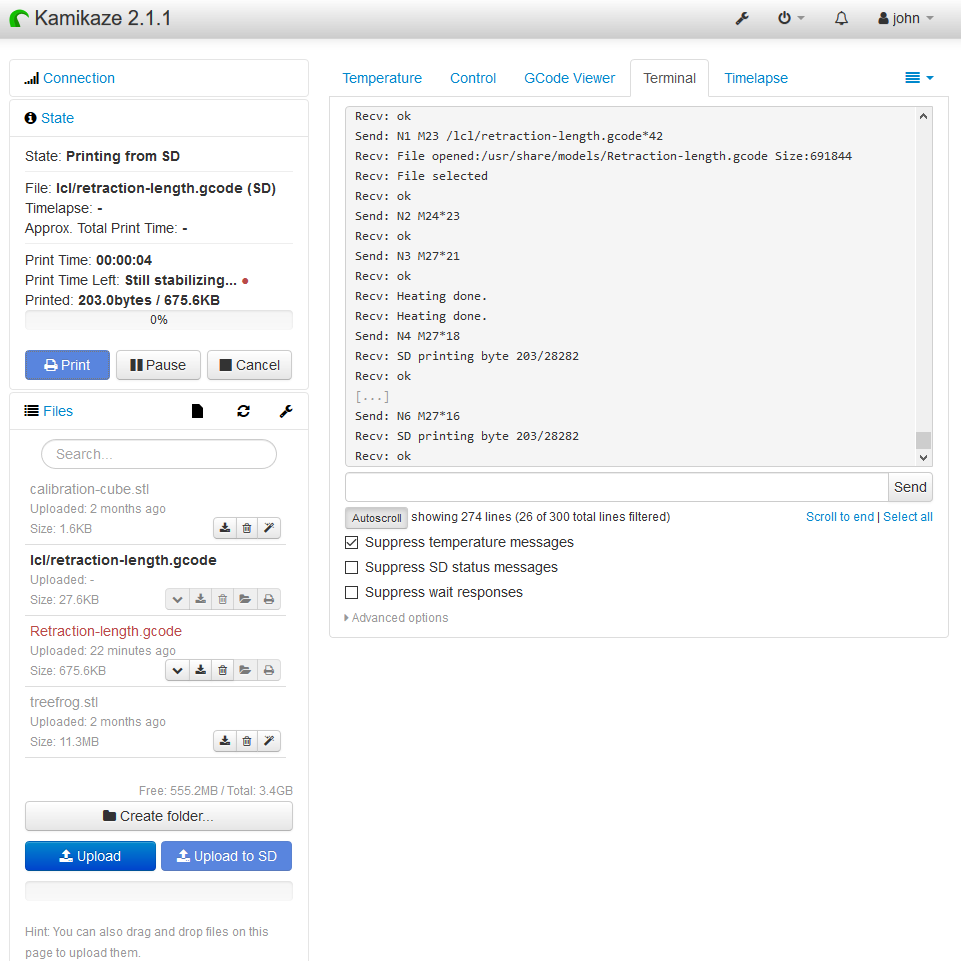

If you’ve been having stutters on prints before, tell them goodbye! Huuuuge thanks to new redeem dev AndrewJ for having built the functionality to read the gcode files from within Redeem, I went ahead and add compatibility for Marlin’s SD controls.
Which means, Redeem now lets OctoPrint think there’s an SD card to print from. So Redeem reads the file directly without Octoprint’s latency being an issue. The result? See the screenshot below.
