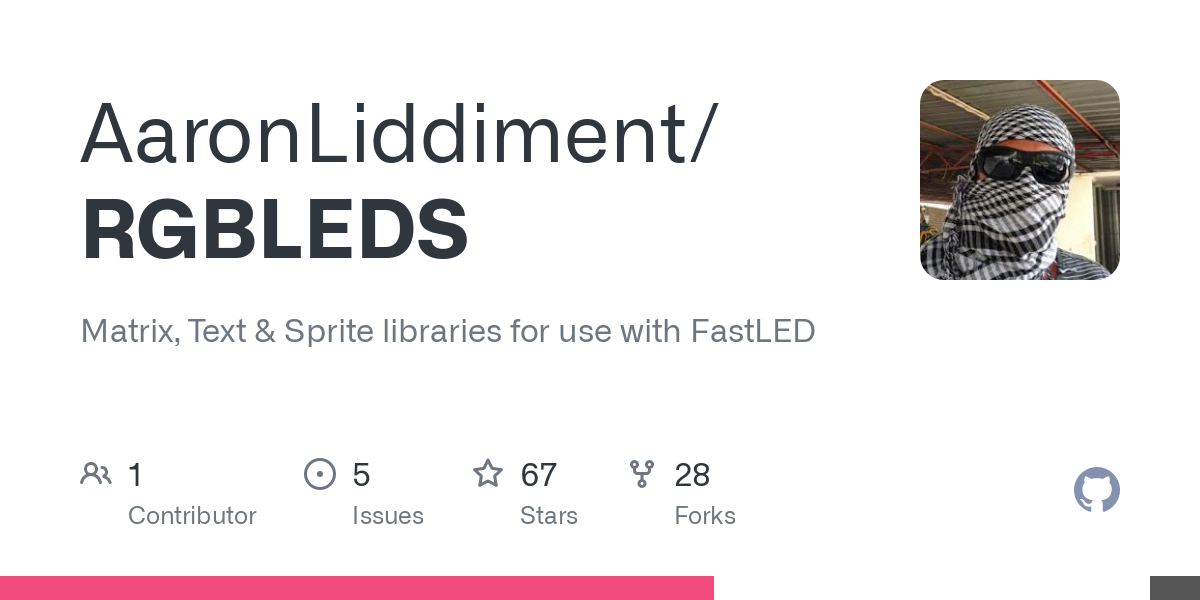

I’m not really sure if it would be useful to you or not, but just wanted to let you know of @Aaron_Liddiment 's cLEDmatrix library if you haven’t seen it.
I will be looking into this asap :slight_smile:
