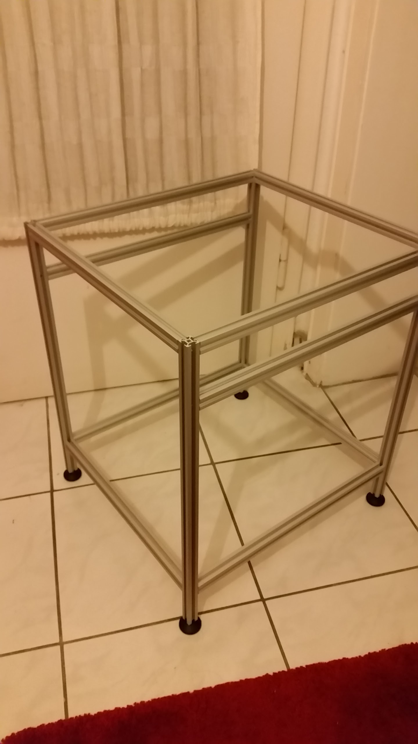

Hey Guys, i know some of you like to see the new printer beeing built so here are some pictures of my current state.
I finished the bare frame and started printing some components. I decided to extend one of the X/Y axis by 40mm so i can switch to a dual extrusion head without loosing build space if i want to.
