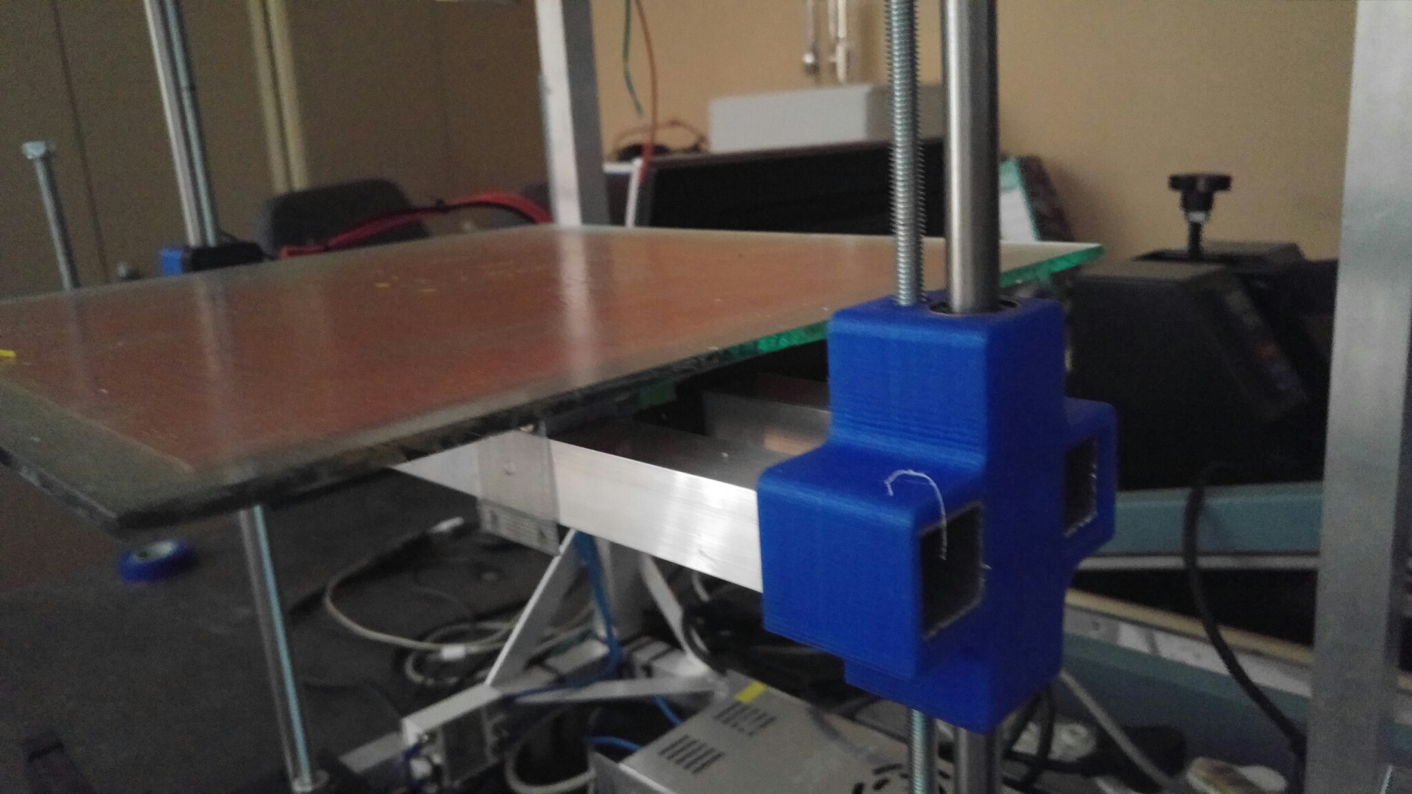

Is your Z and motors on either side of the print bed. Maybe a pic. I have 2 a motors and swiched from 8 - 12mm rods but had to make other chamges to stop the wobble. In the end I moved the rods and screws as close together as I could. Single rod on either side. It’s 100x better.

Maybe its just to sloppy. The screws seem to resonate and shake and then one stops. Could use some tuning there. Ive found igus nuts for leadscrews and will get those. Maybe someone got a pic of the screw and nut?
