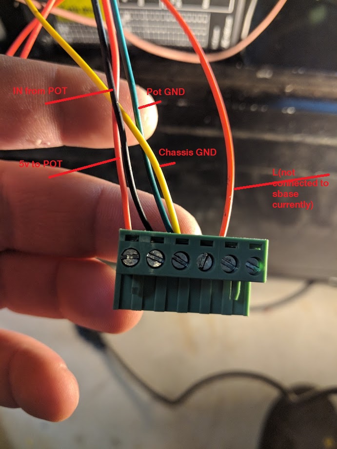

I will get a pic in a few hrs of what I have wired for u to confirm. But right now nothing is hooked up to the sbase, pot works but with p jumped to g laser always in fire mode

Exactly my thoughts! I’ll get u pictures and edit to label the wires asap!
You have P connected to G and the pot connected as my drawing shows.

Post a picture of just the LPS with its wiring clearly in view, pls.
I would like the pot connected to 5V, IN, G as my drawing shows and T,L,P not connected to anything.
Then see if when you turn on the LPS it fires.

Is the LPS currently connected to the controller in any way. Can you post a picture of the connections on the LPS?

We are trying to isolate the LPS and verify that its control works as we expect. Then we will connect the controller?
--------- Starting Step 1: ------
Totally isolate the LPS from the controller: no wires from the controller to the LPS.
No wires on T, L, P.
On the LPS:
Connect the pot across 5V and ground (G) with the wiper (center leg) connected to the IN.
Post a picture of the LPS connector wired like this.
Turn on the supply and see if it fires.
Yes I understand. Let u know in about an hour.
It does NOT constantly fire with the jumper removed from P and G.
1: The picture shows T and P disconnected and the annotation shows that L is not connected either… Y/N?
2: If you plug the connector in like the picture shows it does NOT fire the laser continuously …Y/N?
3: if you only add a wire from the P to ground and plug it in the LPS fires constantly Yes/No?
1:Y-L is not connected
2:Y-No it does not
3:Y-It fires constantly
Hope thats clear enough
