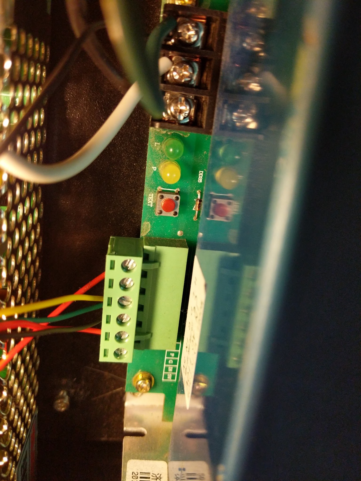

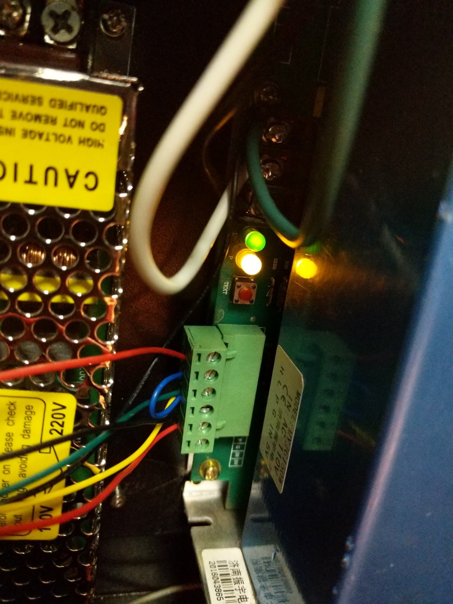

yes…I’ll attach the jumper again and take a pic of the leds to show u
That picture is suggesting that L is asserted???
Ok disconnect the P and plug it back in and show me the LED’s
Yes but it is not. L is most definitely not connected.
Ok doing that now.
