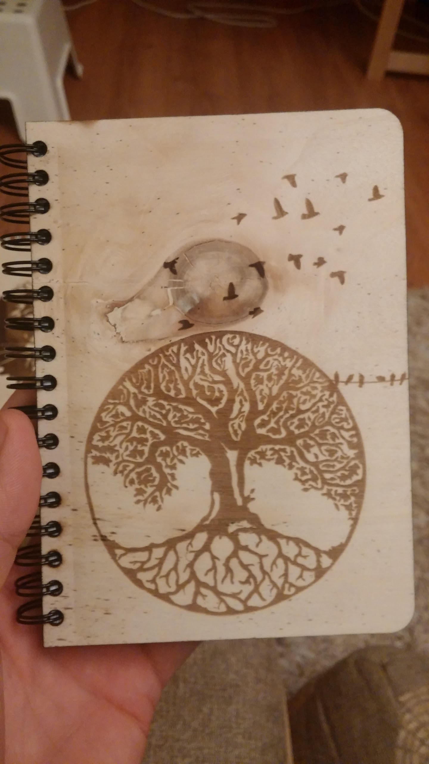

Hey guys! I wanted to share the experience, maybe you’ll have some suggestions :slight_smile: I’m trying to use papertape to avoid burning marks but it’s not going as well as I was hoping to. My laser engraves very nicelly without the paper tape like in the picture with a tree which I like very much but I got the cut marks on the left side even though I had a tape on the spot where the holes were made. On the one with a lion I had a completelly coveder piece but when I was engraving it seemed that the tape was highly reducing the power to get to the wood intself and even after second run the tape left the glue on the picture and it is sticky. And of course that is not cool. I tried couple of types of papertape and it seems to react the same. Do you use something for protection? :slight_smile: cheers guys!

thanks :slight_smile: yeah I have tried that but if I’ll make something small like 4x2cm with something engraved inside, it won’t help if i peel the tape off, it because the smoke will reach the cut out area, so at having it just engrave through the tape would be a lot prettier :slight_smile:

Oh I forgot to mention, I do have an air assist, it helps a lot, but I could completely eliminate the smoke marks if I find a tape that is very thin and doesn’t leave the glue on the engraved are. I know people use this method just that I can not find the right material.
