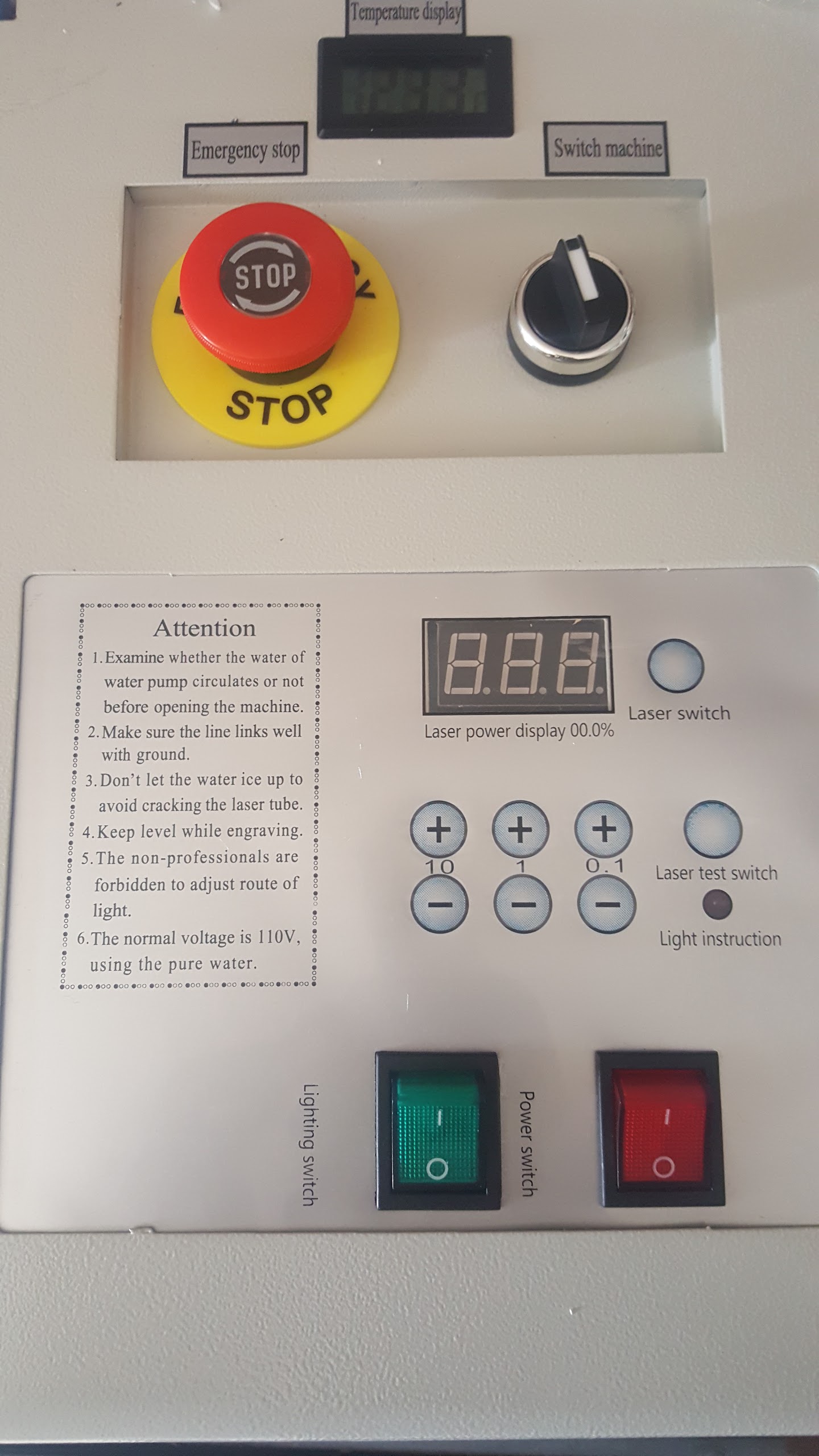

Hey guys, I’m just setting up my new K40 and have a question. Does anyone know what the difference between the “switch machine” button and the “power switch”?
When I turn the switch machine knob everything powers on, including the lights. So it appears as that’s the power button. But if so, what does the actual button labeled POWER do?
Sorry if this is a dumb question, this is my first K40 and the manual i received is for the older model and bad English. And I can’t find any videos with a control panel exactly like mine.
Do you have extra power points at the back of the machine? You’ll possibly find it will give power out to your water pump if you plug it into it.
That is an odd setup. I wonder is the “Switch Machine” the one that turns everything on & then the “Power Switch” like an “enable” or something for the laser? I guess best way to work it out would be to trace the wire paths to see where they all go & hopefully make some sense of it…
On mine, switch machine knob turned on the lights
Best you can do is follow the cables. The k40´s differs alot between sellers sometimes.
They both do exactly the same thing, they are wired in series. The only difference is the button on the left is a BIG RED one and locks off as an emergency switch supposed to do. They don’t even switch each of the sockets in the back. The rocker power switch just switches the laser on and off, same as the little press switch does on the right hand side of the led display. You will also notice that the LCD display for temp reads all of the time, that’s because it’s battery powered so you will need to keep an eye on that as it’s taking water temp from the laser tube.
In the model I have, which visually is the same as the one shown in the photo, the rotary switch turns on the machine and the red switch gives current to the extractor and to the water pump.

Wow… was just about to post a pic of mine (same panel) for a note to @donkjr .
Basically the top right knob controls power overall (if the E-stop isnt engaged).
The laser button to the right of the digital display will turn the power to the laser on or off. If you see numbers in the display it is powered, if its just a decimal point, it is off.
The lower right red switch, seems to only control power to the controller board. So please be aware that it is still possible for the laser to fire even with this switch in the off position.
Hope that clears that up a little.

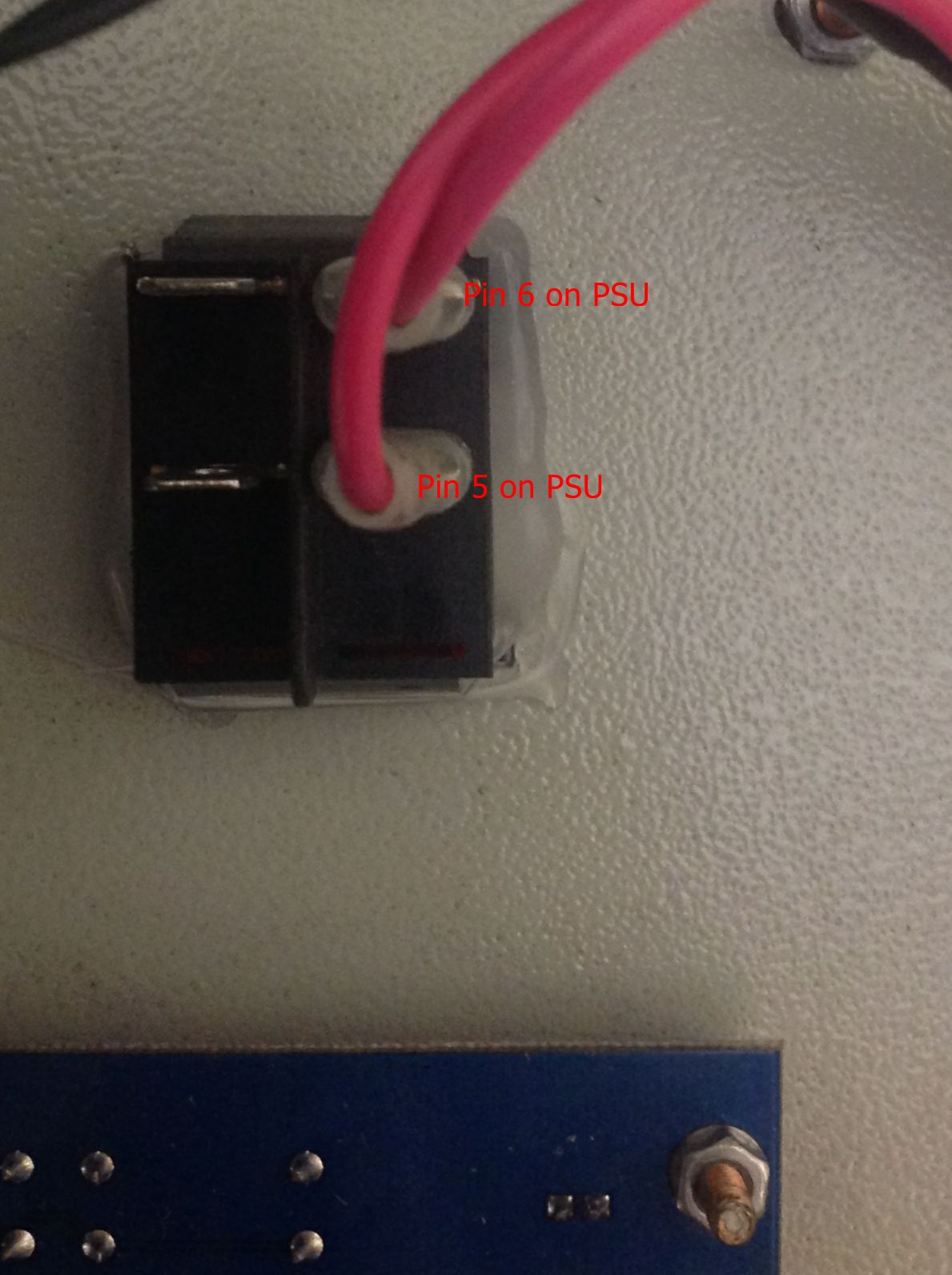

That D+ D- jumper on the red power supply we were discussing seems to relate to that lower red switch that powers the controller. I had left the jumper off, thinking it was pointless, and did a few test fires with the button… everything normal.
Next I tried running a quick cut job, steppers moved along with the job, but laser wasnt firing. If I pressed the test while it was running the laser did fire.
I powered it all down and put the jumper back on and everything worked perfect. So it appears that the jumper is acting in line with that switch and only affecting the boards ability to fire the laser while still allowing manual firing from the control panel. I can live with that… lol.

@Frank_Dart @donkjr tested a few things today with what Frank said on previous post.
With the red power switch off. (But laser selected on with switch next to LED panel)
- No laser operation when asked for by software, (does start as soon as switch selected on during any Laser work)
- Test button does not fire test.
