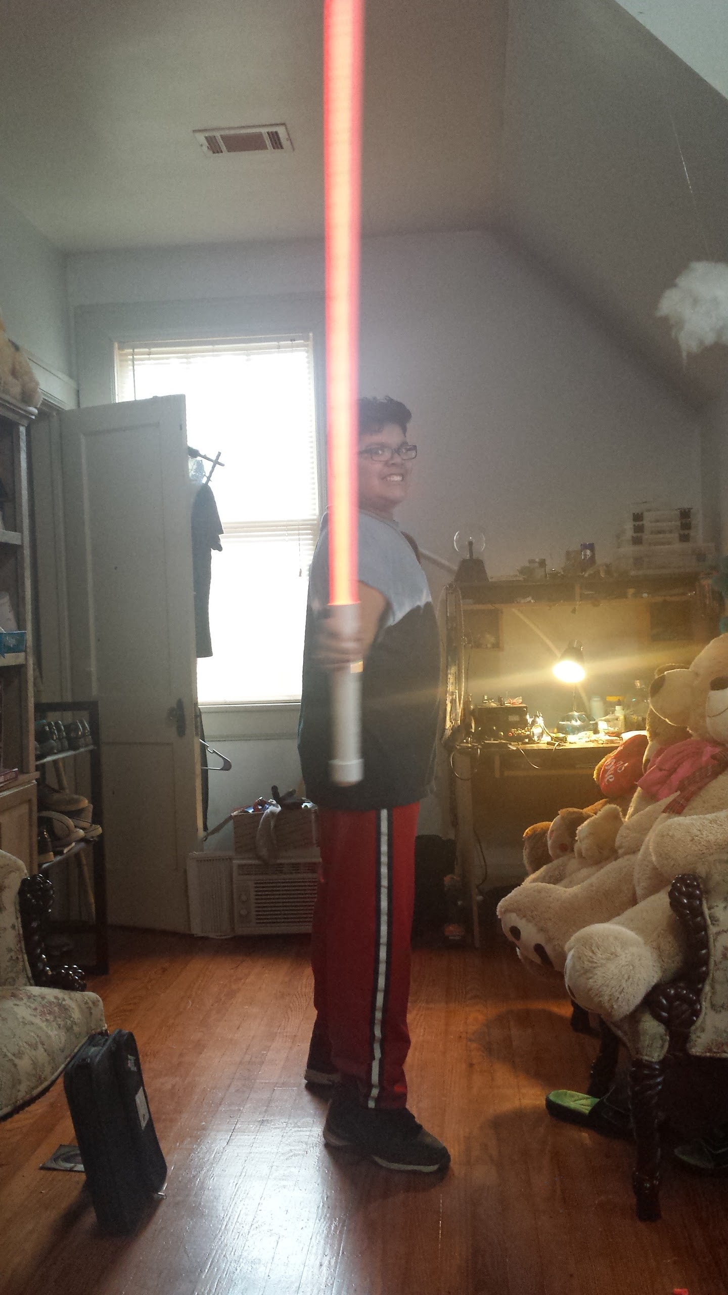

Hey guys im looking for some help with my little brother's light saber.
Hey guys im looking for some help with my little brother’s light saber. Ive been using ColorWipe to wipe a color on to the strip, but so far ive been unable to get the color to wipe in the opposite direction in order to turn it off. My latest attempt gets to the last LED and leaves it on at which point it becomes unresponsive and he is no longer able to turn it back on until he restarts it. But if i do a regular color wipe to turn off the LEDs in the same direction they turn on (which does not look like a light saber) it works fine. Im using swtich case to make the changes.

@Brian_Lewis ​ huh… didnt think about that… let me try that when i get home. My bro’s light saber is due for an upgrade to a stronger tube anyways so i wanna make sure the strip behaves right when i add that second button lol
