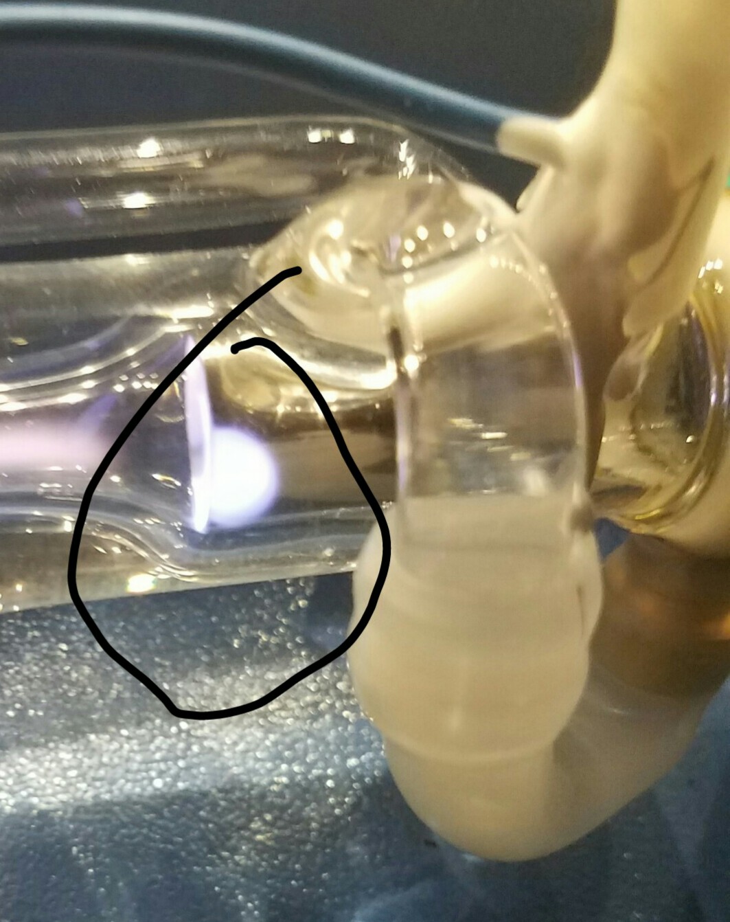

Only thing i can see off is pictured here the laser seems to be hitting the internal metal collar.

I would send this picture to LO support see what they have to say
I did they said well they cant control quality control in another company and they are sorry i paid via paypal im starting a claim with them they dont want to give my money back or send me a new tube. Horrible customer service

The laser beam at the output of the tube is not focused an can not mark metal. But the metal plate in front of the tube can reflect the beam back in the tube an distroy it! Was the picture made with the metal in front the tube?
No the pucture was taken with the metal placed on the bed as where u would normally place things to be engraved
