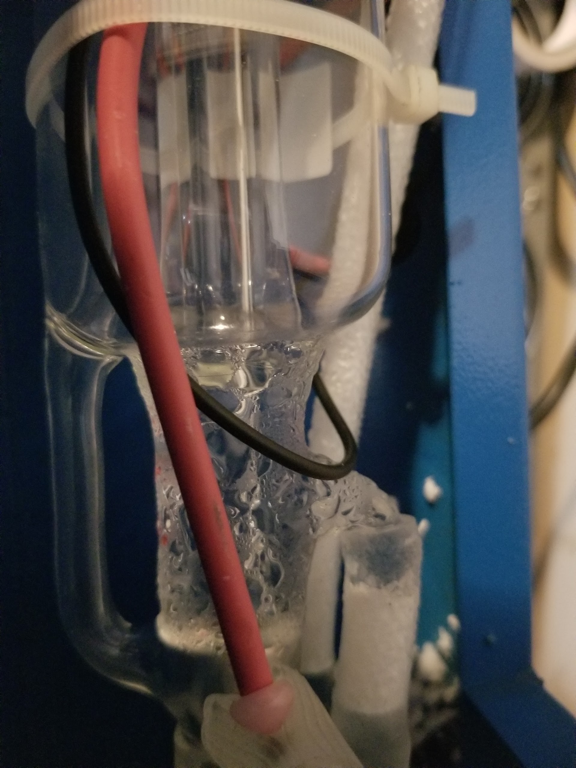

Just was running my laser and I see condensation on and around the laser tube. I’ve never noticed this before and wanted a bit of guidance before I panicked too much. Any ideas what could be the problem?

You are lowering the temperature of your tube below the dew point causing condensation
Yeah and the dew point will depend on the temp, humidity and atmospheric pressure where the laser is located.

You would be better off running at 24-24c without the ice packs than at 19c with condensation
If you are doing this in your home in the basement or in an inclosed room you could just add a dehumidifier and dry out the room first

I didn’t even notice it until I heard and saw sparks out the back where the tube is. Any ideas whether the tube is blown or could it be another problem?
You were arcing to ground
Not sure. When I test fire I see and hear a small spark. Is that it?
