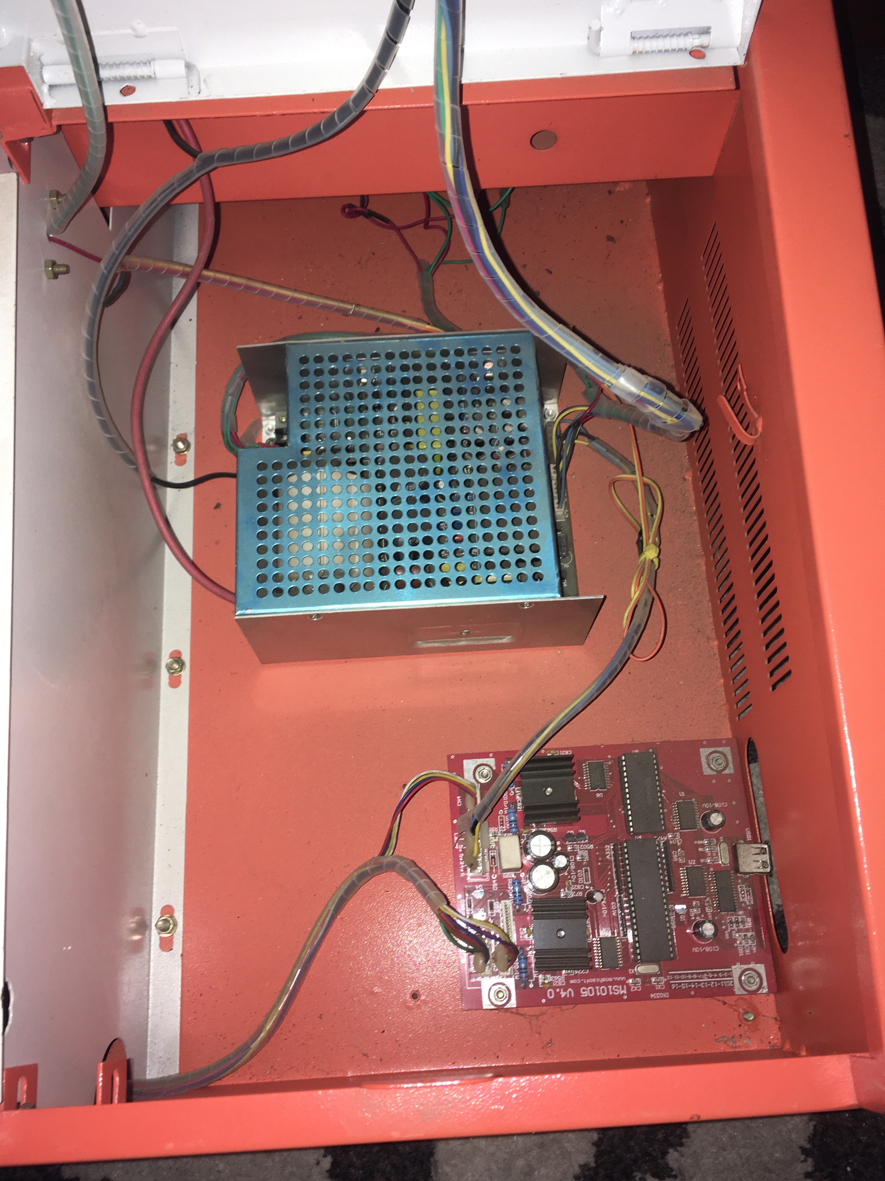

Post a picture of the laser supply please.

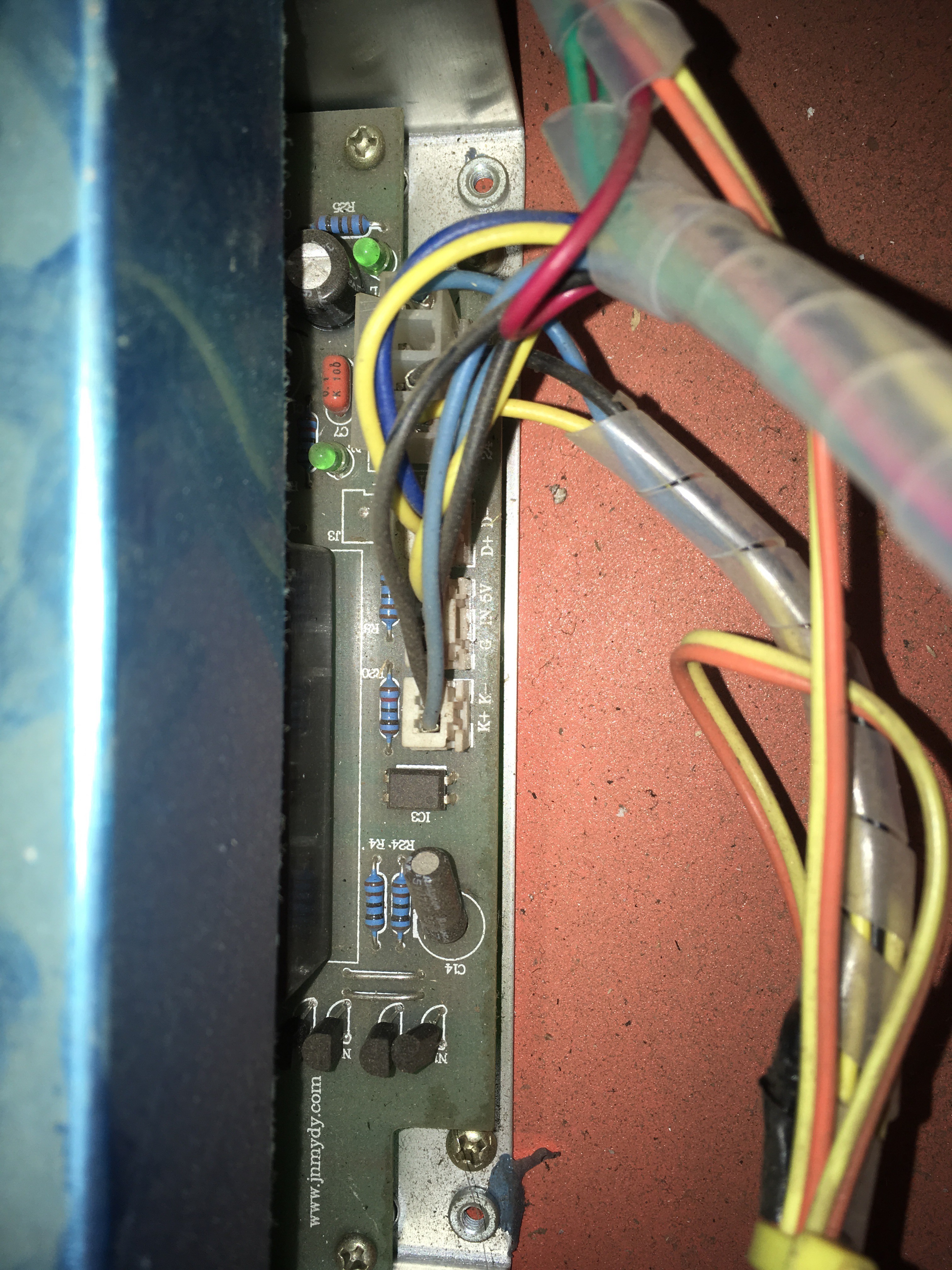

Did your machine have this conecttion: k+ k- g in 5v d+ d- 24 GND 5v???
I’ve seen some machines and they dont have this configuration so i dont know if this gonna work with the awc708c.

@donkjr I’ll do it when i get home.
Thanks
@Cristian_Huanquilef post a photo of your power supply

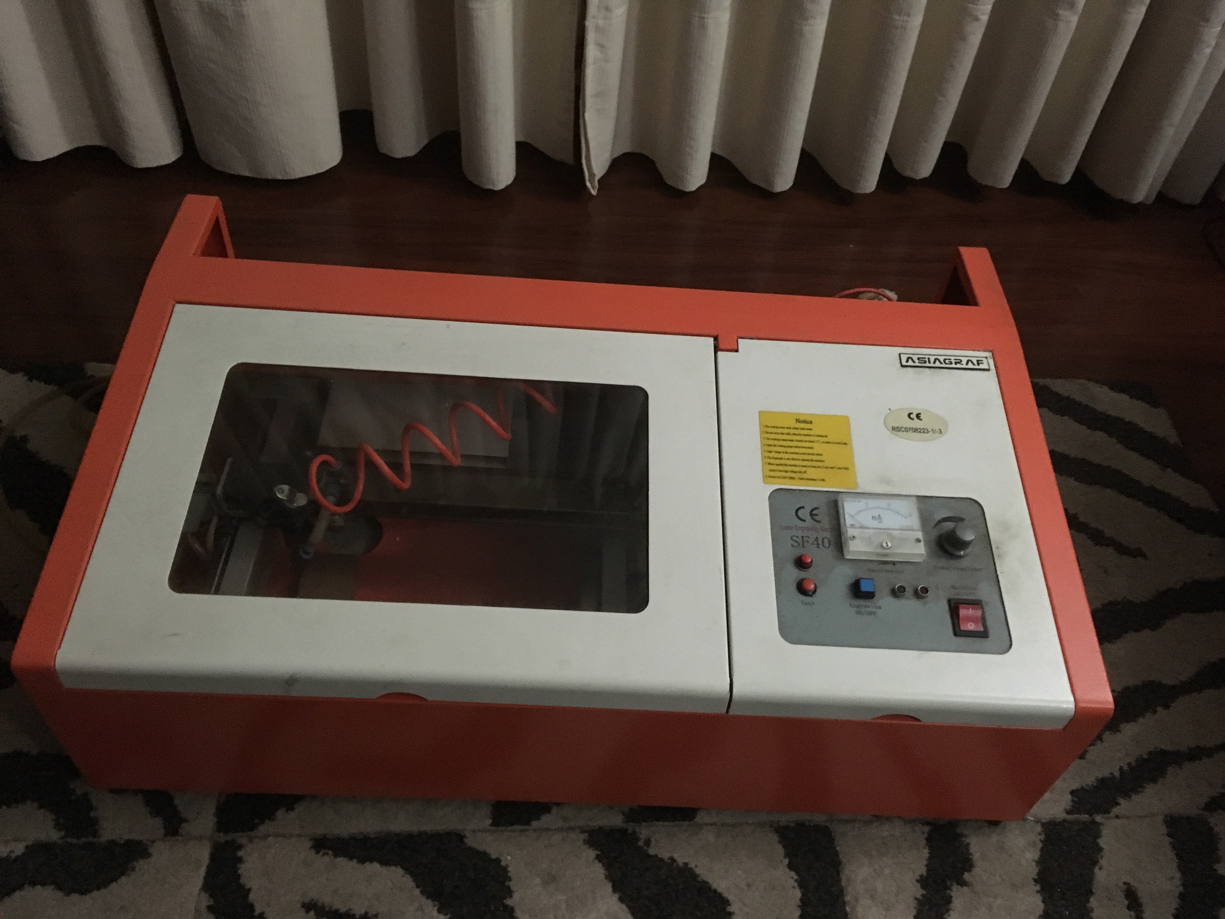

@Cristian_Huanquilef never seen this model before. How old is it?
@Paul_de_Groot I have seen two of these. It works the same as the white connector type except the D+ and D- which had some thing weird about it. I would have to it up in my my notes…
@Cristian_Huanquilef it would do you well to draw a schematic of how this is connected before you do a conversion. Also take pictures of all the connectors with their labels showing. Especially the control and DC power connectors.
@Paul_de_Groot Not sure but it is pretty much the same as every chinese machine
@Cristian_Huanquilef certainly similar but not the same panel as the majority of machines.
@donkjr OK. I’ ll do it as soon as i can. So what you reckon abou it ? Is it possible to do ?
Im pretty sure i can do it but my doubt is if i can use the same laser power supply with the awc708c

The LPS in you machine appears to have equivalent functions to a standard supply. Standard supplies are used in upgrades to AWC708C so I do not see why yours would not work.
