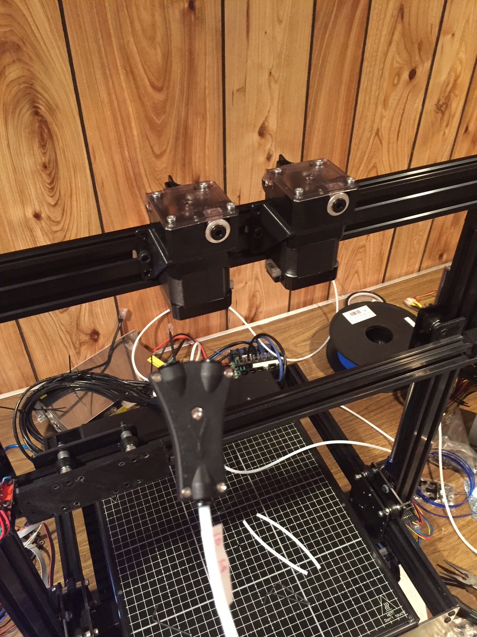

I just got a similar Y splitter item in along with a few Titans. I’m using my Cohesion3D ReMix board which actually supports triple extrusion - I’m thinking of putting in a chimera so I can do the full combo of a single direct drive and the Y flipper into the other slot via these bowdens.
Anyways, you’d be upgrading to the 32 bit motion performance of smoothie and have the capability to add even a 3rd extruder, as well as a bunch of powerful MOSFETs including a 20 amp heatbed one. @Griffin_Paquette and I have quite a bit of printrbot experience between us.
