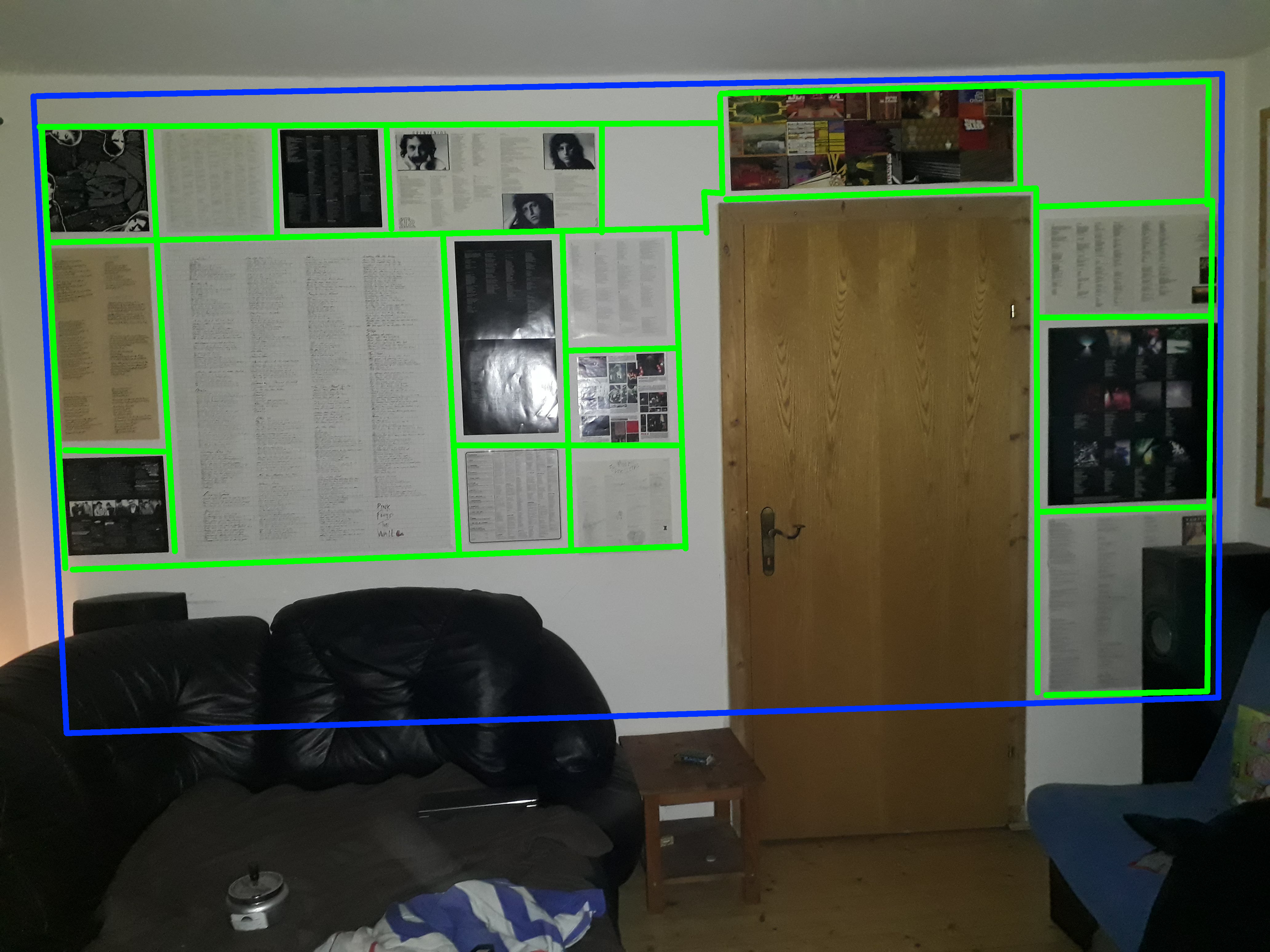

so i got this wall in my room just standing there, doing nothing.
Now i thought i’d throw a visualizer up there, with a matrix shown in blue and actual strips shown in green in the attached picture. I expect it to be around 600*300, but only filled with some of the pixels. I hope to drive it with an ESP8266, as i have one lying around.

I don’t understand what a visualized is, or how the green strips relate to the imaginary 600x300 matrix… I just watch the comments i think too.
@Gibbedy_G The visualizer would be some program reacting to music played in the room.
Along the green lines lines are the “active” pixels of the (blue) matrix.

When I think about how I would do this I run out of memory instantly… I think your visualiser software must know about the layout of your matrix strips and calculate what to turn on.
What will make a key difference is if you are trying to run standalone from something like a Teensy, or just as a bridge. There are examples of how to take lighting protocols like dmx and e1.31 and output the LEDs. You would then use lighting control software to drive the matrix and map each led to the matrix in the lighting app (e.g qlc+)

After looking into qlc+ i’m getting a little pessimistic on this project as the full matrix would be 180k pixels and qlc+ cannot even map all of those within DMX limits.
So, am i dreaming too big here or do you think it can be done?

@Daniel_Gunsch An alternate mapping idea here:
https://plus.google.com/+JasonCoon1/posts/PsFjSyFbf2e
In particular, note Mark Kriegsman’s comment.
