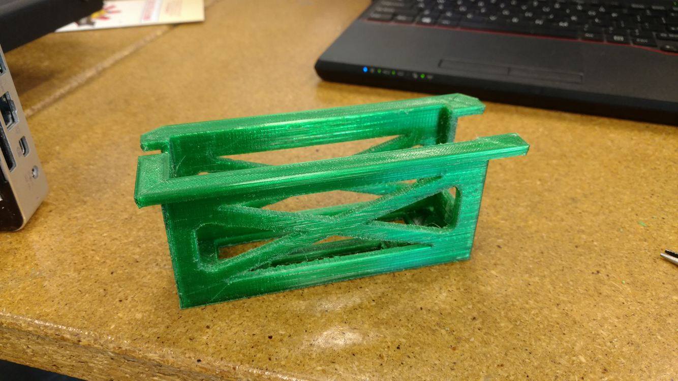

Hey guys, somewhat new to 3d printing with PETG.
I had a few fairly decent prints about a month ago (first pic), albeit a bit hairy.
Now, my prints are turning out terrible with the same settings (next three pics).
Could my filament have absorbed moisture? My box claims to be airtight, though some rice I had in their previously did go bad.
The weird thing is that all the prints have decent initial layers.
Also, these last three pics were at least 12+ hours of printing, overnight.
Thanks for all your help!

looks like underextrusion, maybe as a lot is oozing away on travel. Try to print a cube (no travel) - Also check for transport
YOU ARE PRINTING TOO HOT (sorry for the caps), i have been trying to print like crazy using eSun PETG, and i finally manage to make it work, heres my settings:
Simplify3d
0.2mm Layer height
238c Hotend
5 mm/s First Layer
90c First Layer
25mm/s Print speed
85c other layers
1 mm Retraction
120mm/s Retraction speed
I dont know what you use for bed adhesion, but im currently using glass+buildtak+glue stick, once you get adhesion on the first layer it wont move unless you kick it. hope it helps.
