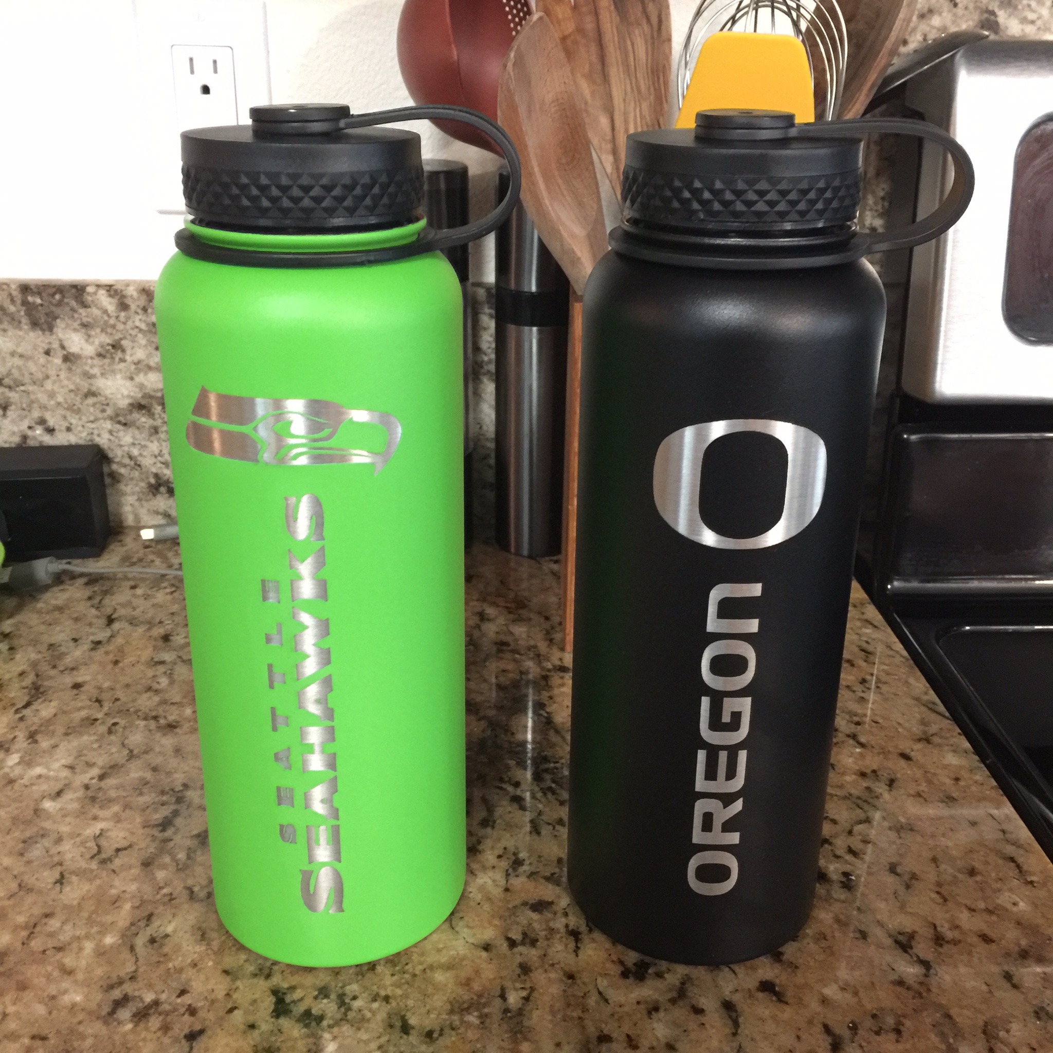

Thanks @Brandon_Satterfield very good point on the enclosure and safety. I like my eye balls and plan to keep them. I think I’m leaning more towards freeburn. It has the larger footprint, I can enclose it, and I should be able to add an A axis to rotate the bottles I’m engraving. The JTech 2.8 watt struggles to effectively burn off the paint coating on the bottles. It works but I end up spending allot of time cleaning up the area and removing leftover paint with acetone. If I build from scratch I can purchase an 80w laser and have some serious cutting power. I also learned that you can make your own laser mirrors with old hard drive disks. The aluminum alloy disks should be easy to cut on the OX.
