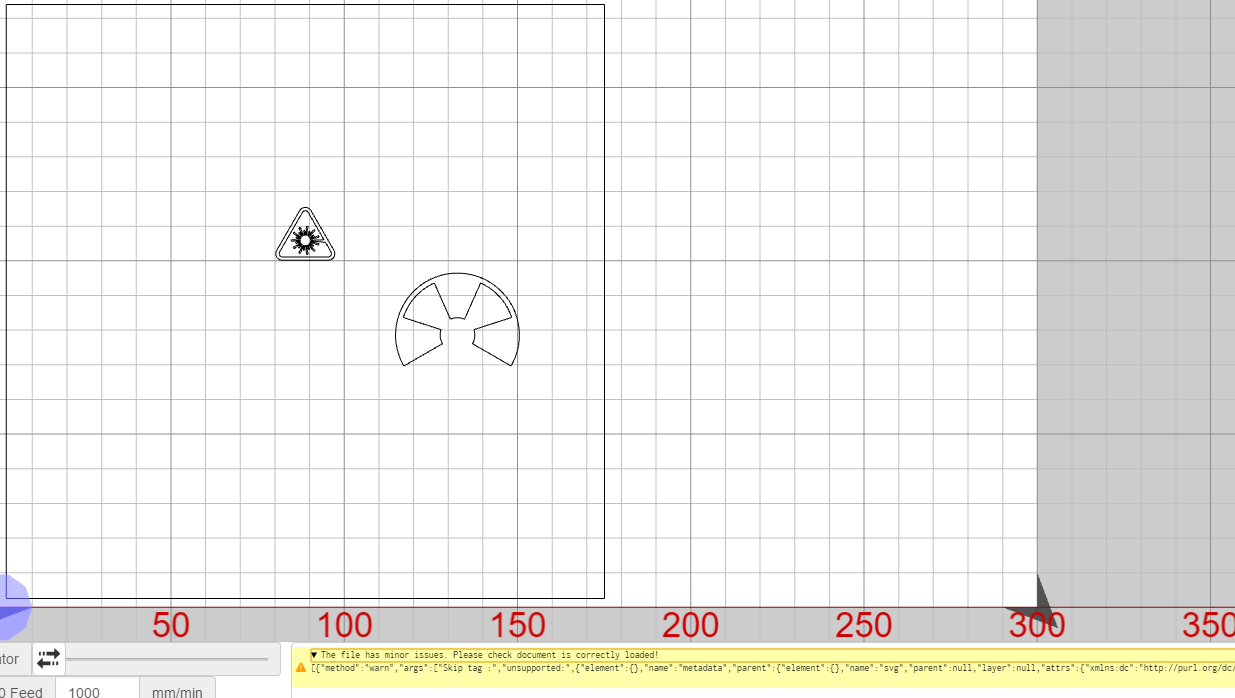

Hey guys! Whenever I export an SVG from Illustrator that has text in it, when I try to import the file into LW4, it does not import the text and gives me an error (see bottom of pic). The text layers show up, just no text on screen. SVG export settings are set up correctly going off of other tutorials. I have been converting the text layers to PNG files to get them to show up so I can etch them, but is there a way to keep it all in one SVG file? Right pic is the PNG of what it should look like.
You need to Create Outlines on the text before saving @Dustin_Corbin
You are awesome. @Ariel_Yahni_UniKpty Thanks!
