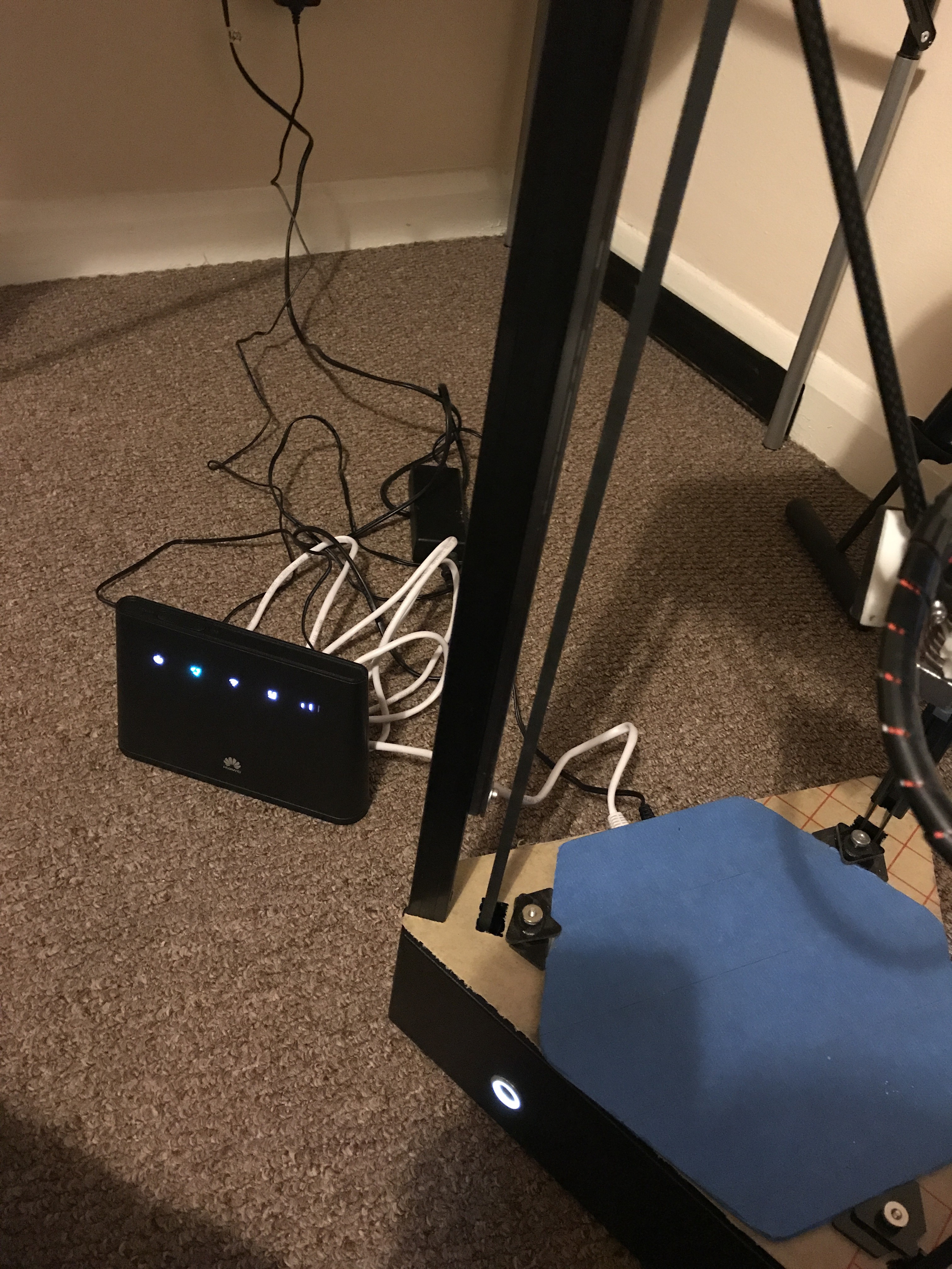

Hey guys wondered if anyone can help. Trying to connect the Ares through a Mac which only has thunderbolt bridge and USB connectors, no ethernet, thinking it could simply connect to the wifi router’s ethernet (although my router isn’t a landline as its more of a home dongle).
Now I’m following the instructions for sharing the internet but it doesn’t seem to be connecting through the router. Does the ares need to be connected to the printer to the Mac first?
Could you clarify your current connection? The first picture seems to show a cable between Ares and your router, and no cable to your MAC. I assume that your MAC is connected to the router via WiFi. If this is correct, all you have to do is to determine the IP address that your router assigns to Ares. You can use arp -an to make discovery as the Simplified User Manual suggests. On a MAC, most often you can simply use the name octopi.local (or octopi) even without knowing the IP address, thanks to Apple’s Bonjour. Just point your browser to http://octopi.local/.
@whackyhack Oh sweet that fixed my current predicament! Cheers Yuan! Much appreciated!
