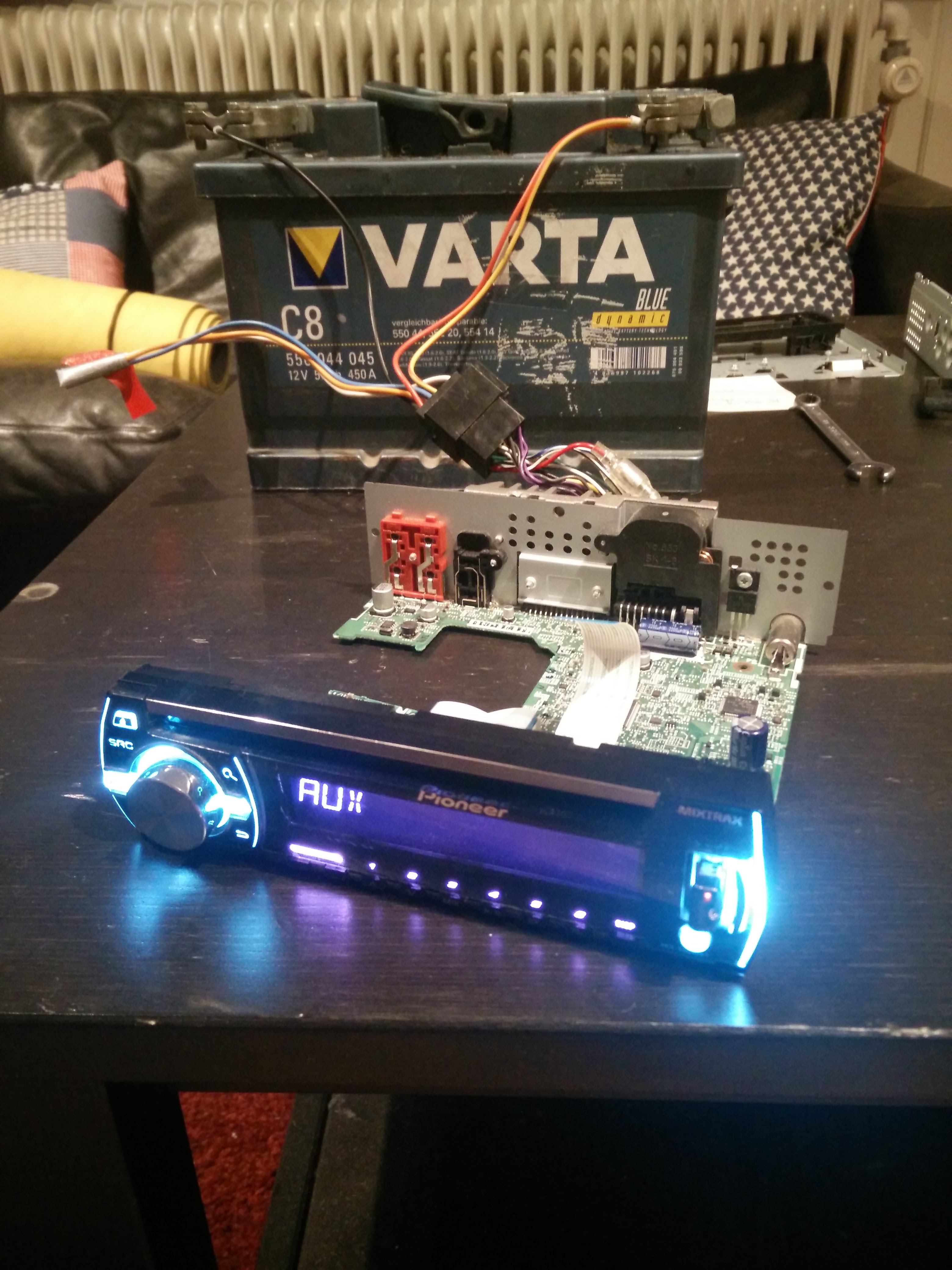

To the point: I want the RGB leds in my car stereo to be controlled (possibly with FastLED) from an Arduino ProMini. There are two “leds”; The key color which is the color of the module and buttons, and the lcd color which is the color of the text on the screen.
I have disassembled the car stereo and done a lot of research, found schematics etc. and from that I’ve created my own schematic of how I think the problem could be solved.
My car stereo is the model Pioneer DEH-X5500BT. I haven’t been able to find the schematics for that exact model but I found them for the DEH-X3500UI and so far when inspected I haven’t found any differences between my physical car stereo and the other one. Neither on outside looks nor in the document with the schematics (in the area referred to the RGB LED controlling). And the main MCUs being used are the same.

I have attached a bunch of images that hopefully explains it a bit better.
