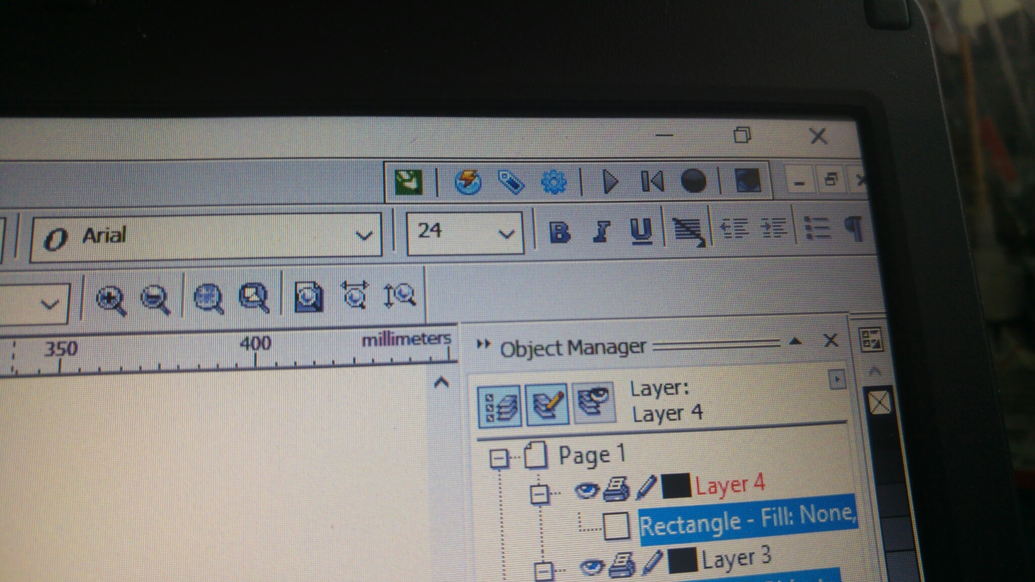

Hey, has anyone got any idea why after some time the corellaser cut, engrave and other buttons in the top right corner disapperar after some time working in coreldraw?

These. I don’t think it’s the dongle that causes it

Actually this is very normal. The buttons are going to be in one icon in the bottom right corner of the computer next to time/date. You need to right click on the icon and then you will see the information. The icon is going to be reddish pink in color.
Guys at one of the facebook groups said it’s a glitch and the buttons appear down by the clock

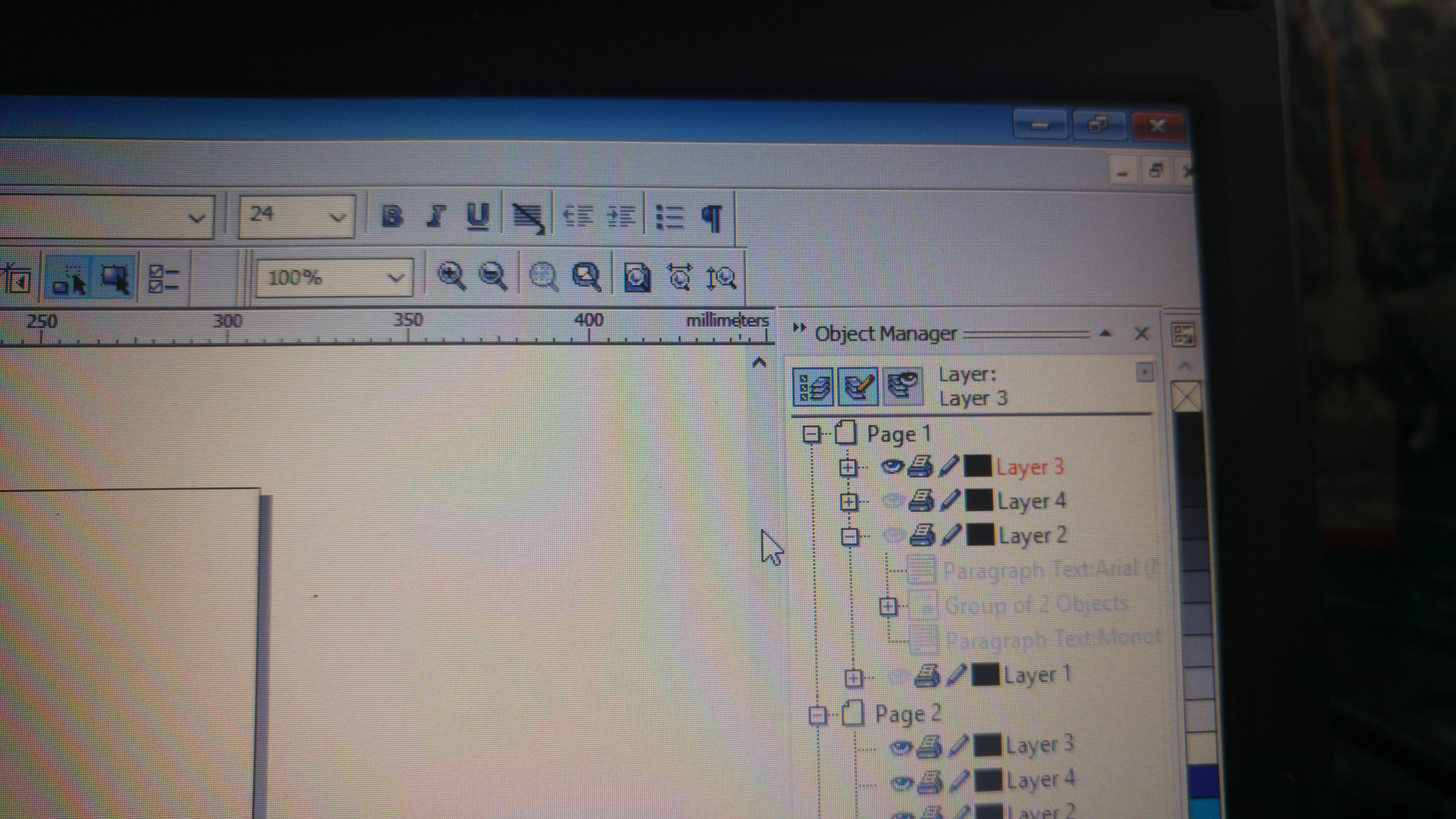

@HalfNormal and how about the buttons in the top left corner? The file, edit, view and help? Sometimes there are only 4 of them and sometimes 11 with text, bitmaps, layout, arrange and others. Do these hide somewhere else too?
That is a behavior of the drawing program and it all depends on which screen you’re in. A quick search on YouTube will help you learn the drawing program
