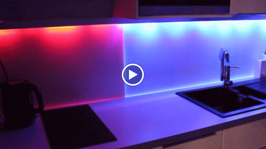

I posted about this problem some months ago but have since stagnated my work on it. I really really want this LED setup to work properly so lets give it another go!
As you can see in the video after a while the led-strip freezes it’s animation beginning with the leftmost LEDs. When i turn it off and on again it’s still frozen. If I wait for a while before turning it on again it’s working again for a while.
What could cause this? Is it maybe cause by some overheat protection in the LEDs?
