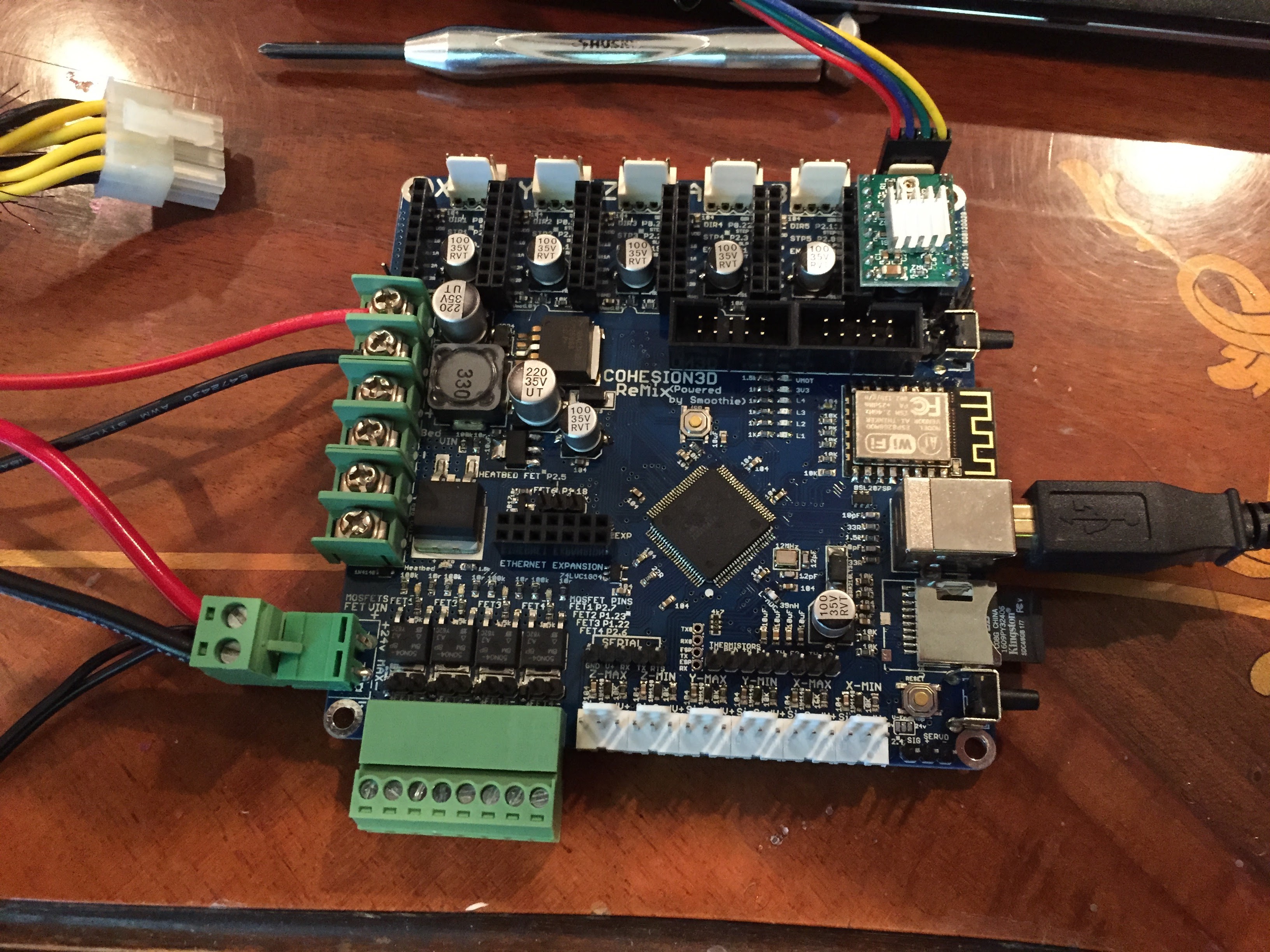

@Rene_Jurack my larger board, the ReMix. I believe we may have discussed it before. The factory just sent me pics, the samples are coming along well :slight_smile: This pic is not from the factory though:

As I look at your provided picture, it looks like it has it all?!
-24v YES.
-4 Thermistors YES.
I have a total of 6 MOSFETs. One is for heated bed, 4 more for heaters/ fans/ other stuff, and 1 remaining tiny mosfet for fan/ small LED.
This leaves exactly 1 pwm pin which is broken out to servo/ expansion header in the lower right. Those are all the pins the smoothie IC has (nothing left unused), but keep in mind you may be able to pull a few additional digital outputs from the GLCD connectors if you do not hook up a GLCD. You can also use the unused mosfet outputs as DO, just the signal will be inverted (quick fix with a 10k resistor inverter, or just use the really good mosfets on my board :slight_smile: )
Yeah, using the DOs from the GLCD-connector will work for me. Now the important part: When will I be able to hold one in my hands? (Germany here) :wink:
