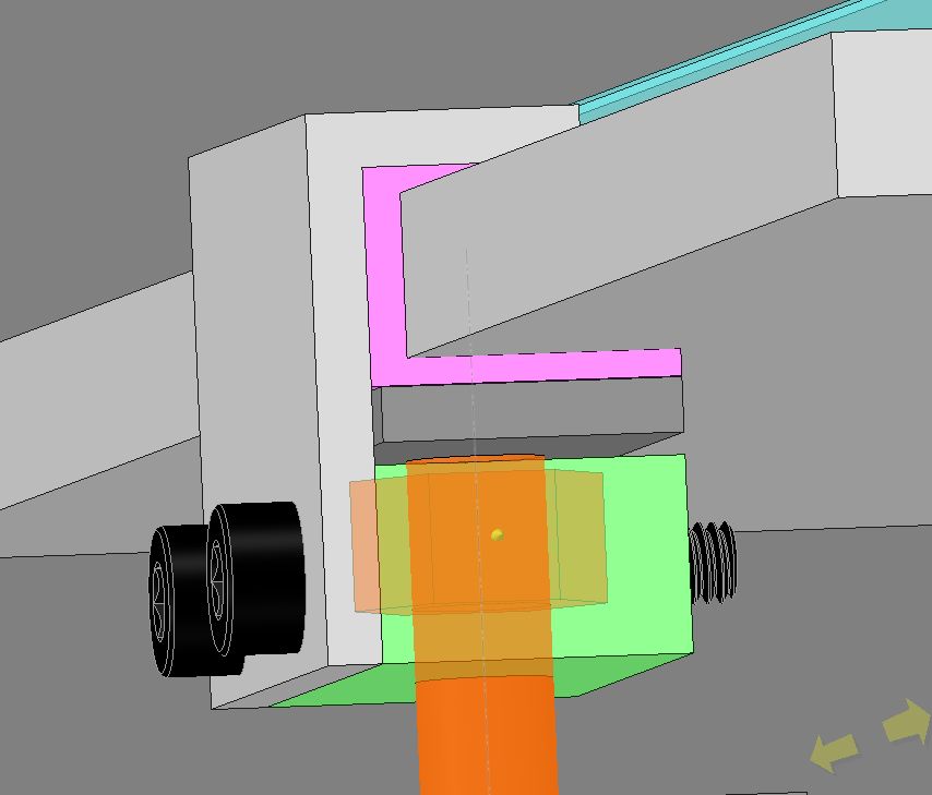

Hey is there a suitable 3D printable plastic that would do good as the green piece in the attached sketch? This is a preliminary design for a 3point adjustment bed clamp, where the wite(ish) color is aluminum, dark grey is stell/ss, pink is some sort of rubber/silicone/other insulation (ceramic?).
Forgot to mention, the aluminum will be heated by a silicone pad.
Thanks for your input.
PC should do fine.
If you can manage to insulate the parts well, then an ABS-like material could work (with increased creep, though). But PC would be your best bet.
