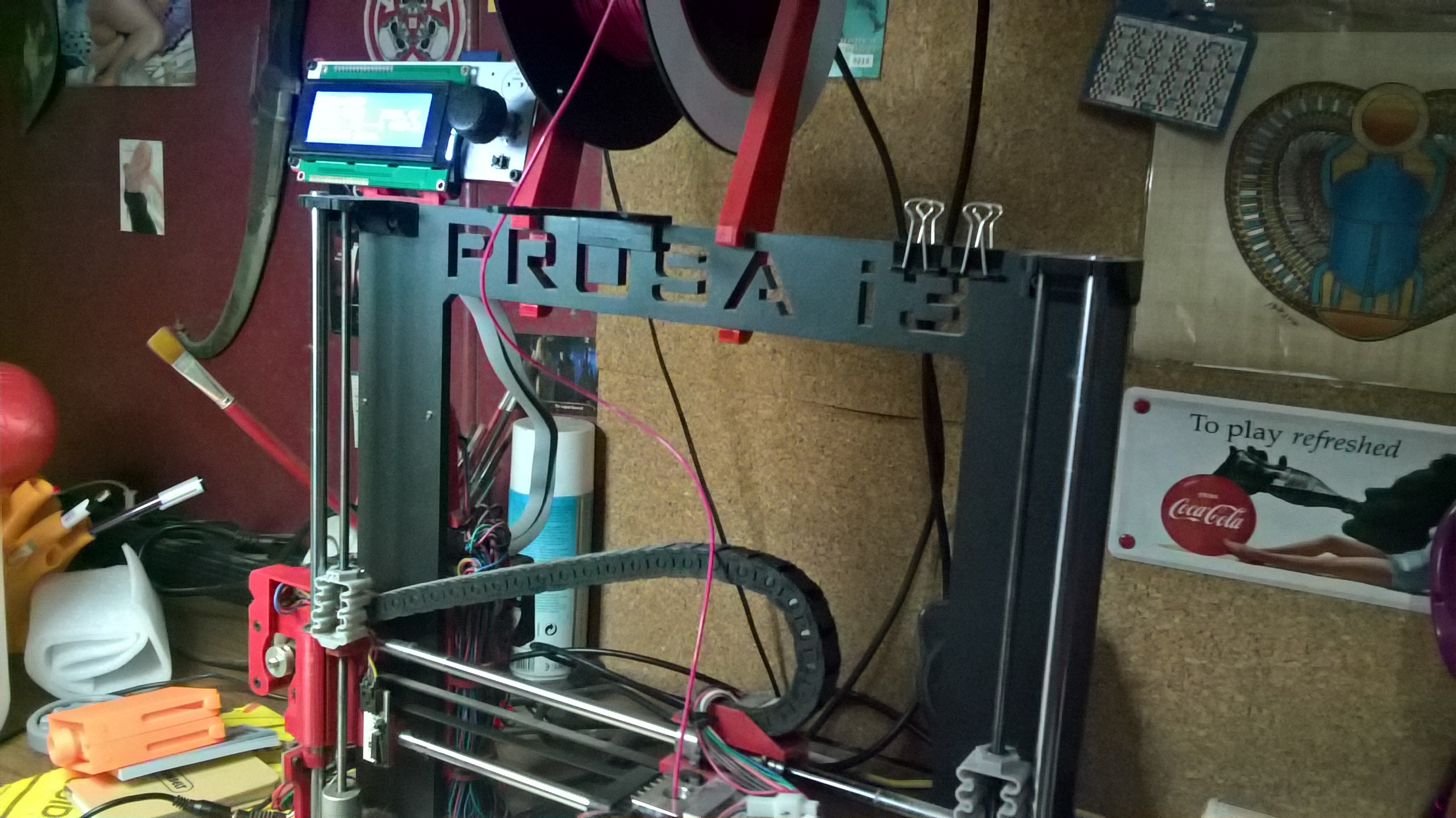

Ive had a Prusa i3 Hephestos since February and ive started having some issues with the filament because sometime after I start printing the filament coming out of the spool starts curling, at first I thought it was a spool issue but then I swapped the spool for one ive used before without issues and the same problem happens. First spool that started happening with was a Verbatim black pla and the spool Id used without issues before and same thing happens now is a BQ magenta pla one. The curl gets worse as it goes on. Im inclined to maybe the problem being with the gear wheel??? Some help would be very appreatiated.
