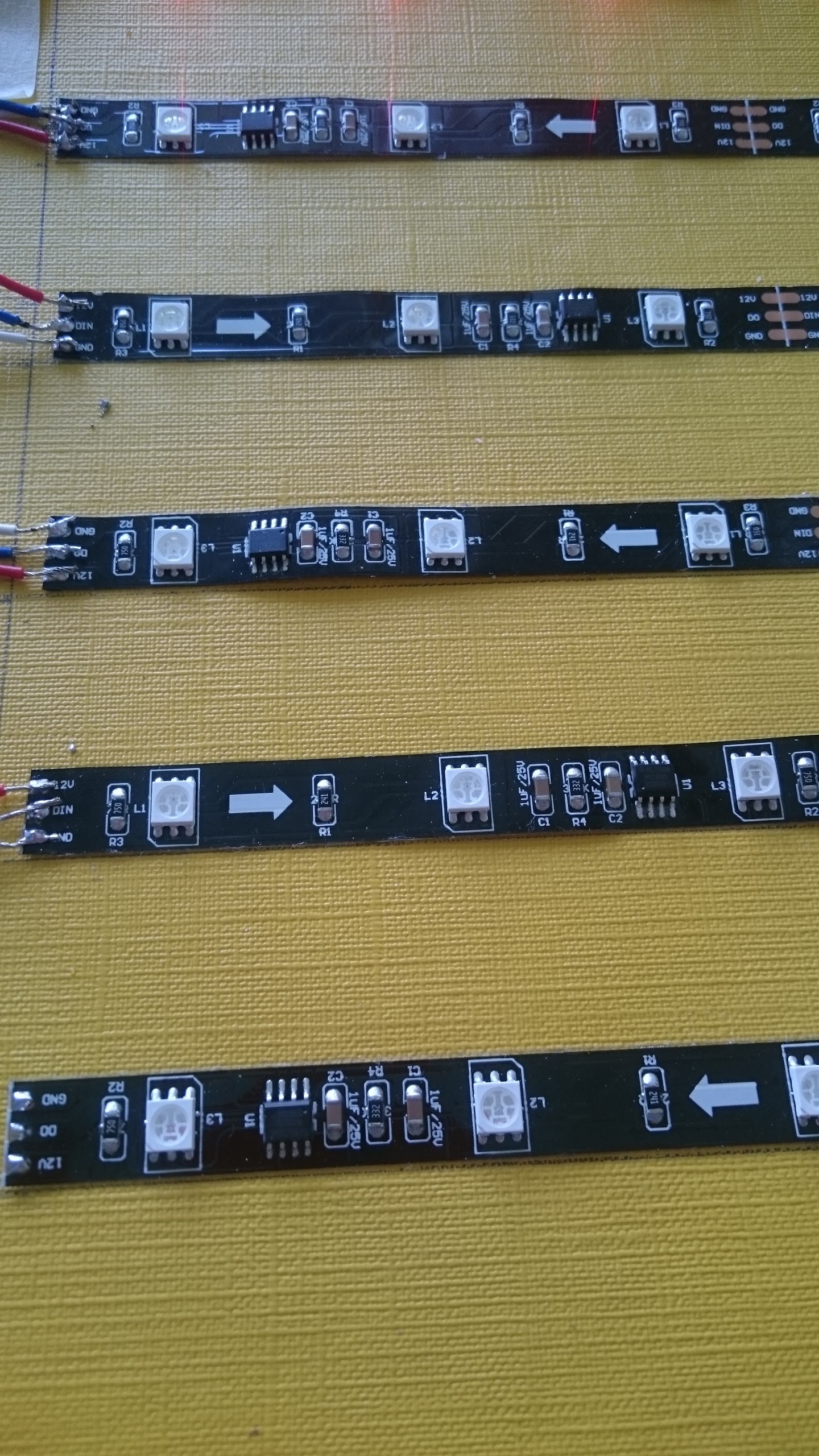

So starting from below, I have created a prototype of 6x6 WS2811 leds @ 12volts and i have ran the “stradtest” example from adrafruit and all the lights worked well. However the pixels seems to be grouped together. Then I proceed to use Daniel Garcia’s Fastled basic usage. Upon doing the tutorial to turn on one pixel but it turned first three pixel on my strip. Im wondering what is causing this. Im happy to know the cause of this phenomenon and welcome any recommendations for my learning process which of course I would be happy to documented on my google plus.

That strip has a single ws2811 IC for 3 regular (non-adressable0 RGB LEDs. That is just the type of strip that you got.
You need to get a strip that has individually addressable pixels.
That, is an interesting strip! I’m guessing its used for accent lighting. Until now, i wasn’t aware of their existence.
@Philipp_Horn If you have 64 of those short strip, you can make a large 8 x 8 matrix (32" X 32") , i use this kind of strip to decorate a large area.
That really is an interesting strip, as it has 3 pins, but the WS2811 isn’t integrated with the 5050 type LED and it’s 12V at that. Also, your soldering is in serious need of improvement. I recommend boning up on your soldering skills and to use heat shrink tubing. In the meantime, I’d recommend getting a real strip of integrated 5V WS2812B’s or even APA102C’s.

@JP_Roy I just read the seller information regarding WS2811 IC. I have 30 leds with 10 IC per meter then.
@Stuart_Taylor @Nail_ENVY Yes, they are accent lighting. Was thinking of 8x8 or 10x10 which i had in mind as i have 100 (bought two products) of short strips.
@Andrew_Tuline I know! I have a old solder from a friend which tip is very rusted and no longer precise and i had sand it off to able to solder but yes It may be time to get myself a new soldering tool
